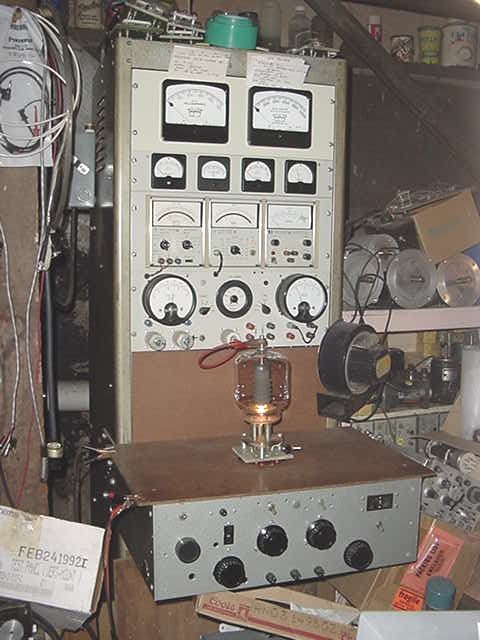

Absolutely yes. Years ago when I built my large tester for transmitting tubes, much like the kind in your icon, I experienced something I called "screen grid pull up". This is a condition where the screen would want to follow the HV potential on the plate. While testing, both control grid and plate would be set to predetermined levels. Then the screen would be brought up to to begin conduction. As the required level was approached, the tube would suddenly take off and draw tremendous current causing me to shut down the power as fast as I could or loose the tube to self destruction.
Well, to make the story short, it wasn't gassy tubes and they weren't oscillating. It was because the unregulated screen supply's output impedance was too high. The fix was to add a high wattage 10K ohm resistor across the supply's output. This prevented the screen from pulling up. And just so you know, there are non-inductive carbon stopper resistors under the plug-in socket assembly.
Now even though these were large industrial tetrodes, the premise can be scaled down a little and should verify your thought.

"I experienced something I called "screen grid pull up"."
I'm not sure that's cathode saturation you saw.
That sounds like screen emission, where the screen gets hot enough to emit electrons, like a cathode, and current is drawn from screen to plate.
A pull-up or follower can't sink any current, can only regulate in the positive direction, not negative. So even if the calculted impedance of a follower is very low, if it can't sink current as well as source, the g2 may run away. I think it's a possibility for g1 to run away also, if operated in A2 and there is not enough pull-down resistance. Gassiness can cause it also.

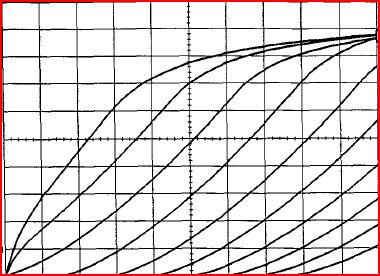

Here are curves from a tube model that show the cathode saturation region, where the curves flatten out at the top.
I imagine there is often some other limit, like grid emission, reached before cathode saturation in most practical cases.
There is another limit that may apply to the original question; on a particular load line, the plate voltage can only go so low before the plate current stops increasing. I believe this is known as "diode mode saturation" or something like that. On pentode curves the minimum plate voltage is called the "diode line". The cathode doesn't saturate in this case, but rather the grid(s) will start drawing current from the cathode instead.

Was this an example of the negative screen current which some big tetrodes can do?
Not in this case. The screen went very positive because it was approaching plate potential. But you are correct in that good (new) tetrodes will experience negative screen current of a few milliampes. As they age it can become positive and it's one of the things to watch for when testing. You can't see it in the picture but the screen current meter (second from left in the row of 4) is center scaled to reveal either.
Nope, wasn't screen emission in the normal sense. Happened too fast with way too much total current. May not have been absolute total saturation because I didn't let it go. With 2000-2500 volts on the plate, the space charge wanted to elevate the screen as if it were floating because of it's high impedance source. This was to illustrate that a high enough screen potential can and will overcome the negative G1 control. In fact the screen grid has just as much (perhaps more) control of a tube's conductance as does the control grid.

Regarding cathode saturation: the saturation spoken of here is voltage saturation, analogous to a BJT's saturation region, or a FET's ohmic region. It is NOT cathode saturation, because cathode current is well within ratings in this region, and it is not current saturation, which occurs at higher plate voltages, where the plate curves flatten out (the linear range, analogous to a FET's current saturation region).
