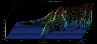

From the tweeter CSDs I've seen I'd say virtually all play the 3-6kHz region fairly flawlessly. Metal dome breakup usually occurs in the 20-25kHz region.
Yup, also why I choose an AMT over any metal dome. Why I also dislike most metal cone drivers, especially midrange/midbasses/woofers with their peaky sharp breakup modes.

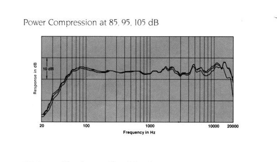

http://www.jblpro.com/pub/obsolete/4411.pdf
JBL 4411, one of my older designs with power compression measured at 85, 95, and 105 dB nominal levels. The actual compression realized would be tied to the sweep rate at which the curve was taken, but these were at a fairly normal pace as evidenced by the curve resolution.
http://www.jblpro.com/pub/obsolete/443035.pdf
Also shown here at 1, 10 and 100 Watt nominal levels for 4430 and 4435.
David S.
I was talking about metal cone breakup in midrange drivers being mistaken for a tweeter issue. Of course soft domes are in breakup as low as 5khz by design.
