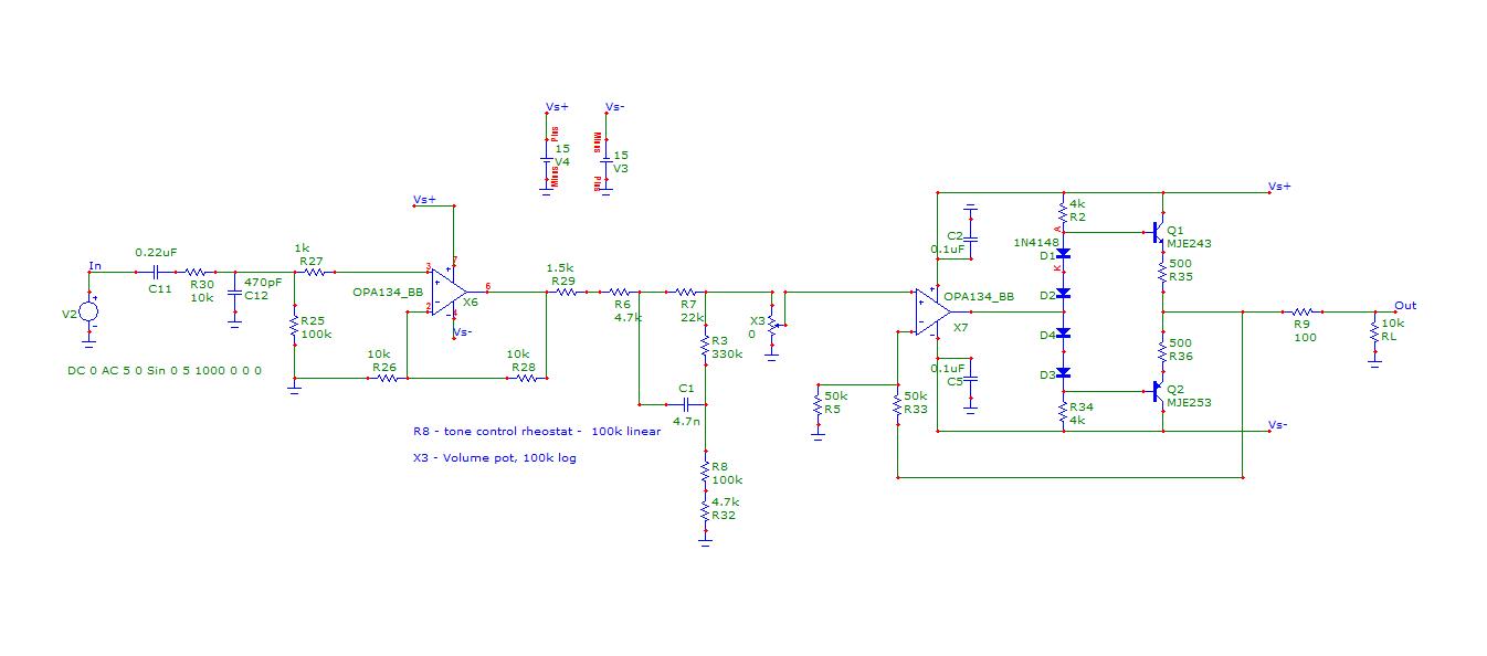

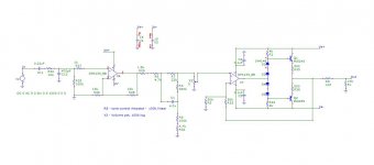

PreAmp for listening fatigue attenuation
Listening "fatigue" – no one can deny that it really exists!
What causes it? Most probably mid and high frequency distortion(s).
Can we attenuate it, in a simple manner? Yes, but, doing that, we will surely sacrifice some of the emotion and soul of the music, of course.
Here is a simple preamp schematic, with a very subtle mid/high frequency attenuator, and a buffer output stage. Instead of two single opamps, it should be used a dual OPA2134.

Your circuit seems to contain just a simple eq. Not really very useful as you'd notice the lack of treble before you noticed any 'improvement'. An eq is an eq... Also what's with the weird output stage. Seems completely unnecessary.
