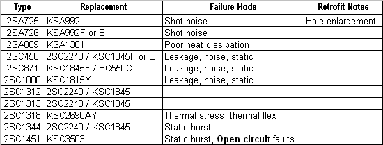

How does one learn which types are “noisy”. Is anybody keeping a table of these?
Sorry skem forgot to post this earlier.

Ian et all, Skem was talking about known noisy *transistors.*. There is plenty out there on resistor noise.
Those types seem to be pretty notorious for problems. There are two categories of “noise” - the noise that’s supposed to be there and the noise that’s not. I wouldn’t classify these as “noisy” because the offending noise is really a reliability problem. They start out fine from the factory and go bad (get noisy - REALLY noisy) in the field. Any time I see an A72x or C458 in a circuit it’s outta there - whether it’s bad yet or not.
That makes a lot of sense and well explained.
I replace those terrible C458s with Fairchild KSC1845. Interesting to know what you replace them with and if KSC1845 are a good replacement?
