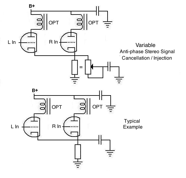

What I'm working on now is a preamp that besides having an excellent tone control system, has variable L+R and L-XR auxiliary outputs. The L-XR (variable amount of cancellation of common signal but with a stereo output) will drive a Lexicon digital reverb which will drive side speakers. The L+R out will drive the center speaker. The only "steering" will be the fact that the L+R output will inherently cancel signals to the degree that they are L-R (on both channels but out of phase with each other), and the L-XR circuit largely cancels anything that is common to both channels and in phase with each other. For anything resembling symphony music, I expect this to be the way to go. For rock music or movies, I expect to prefer using my inter-aural cancellation circuit, with or without "steering" as provided in my Yamaha home theater receiver.

Such a preamp can be promising. I suppose that the Lexicon can be used as a pure line delay and not only as a reverb unit ?

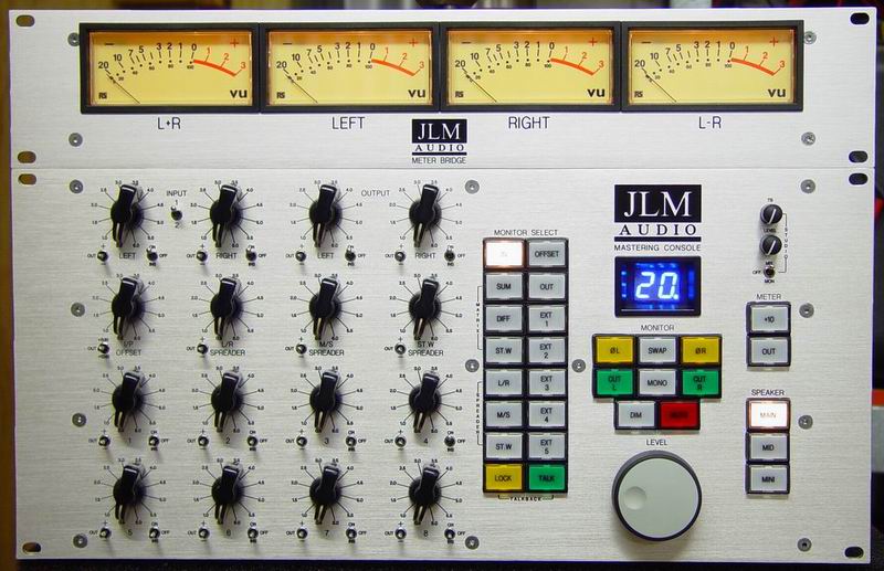

Davesnothere, That console looks like it was designed by an engineer, for an engineer. Not real self explanatory to others. I've been wanting to design and build a surround sound recording mixer for a long time. It would be a fun challenge. Now that that kind of thing is all done in software, it's probably over my head, but you never know.
