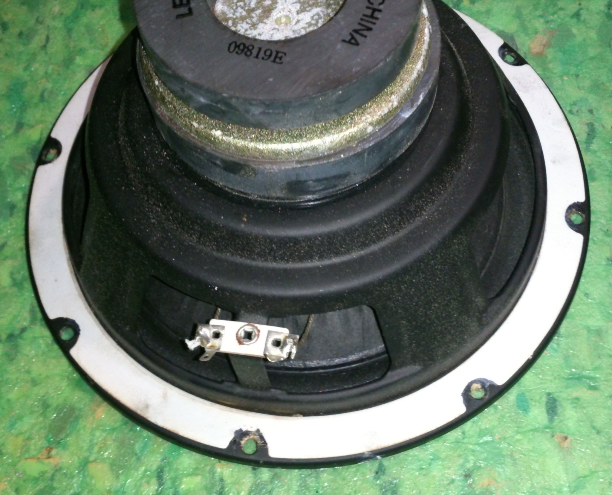

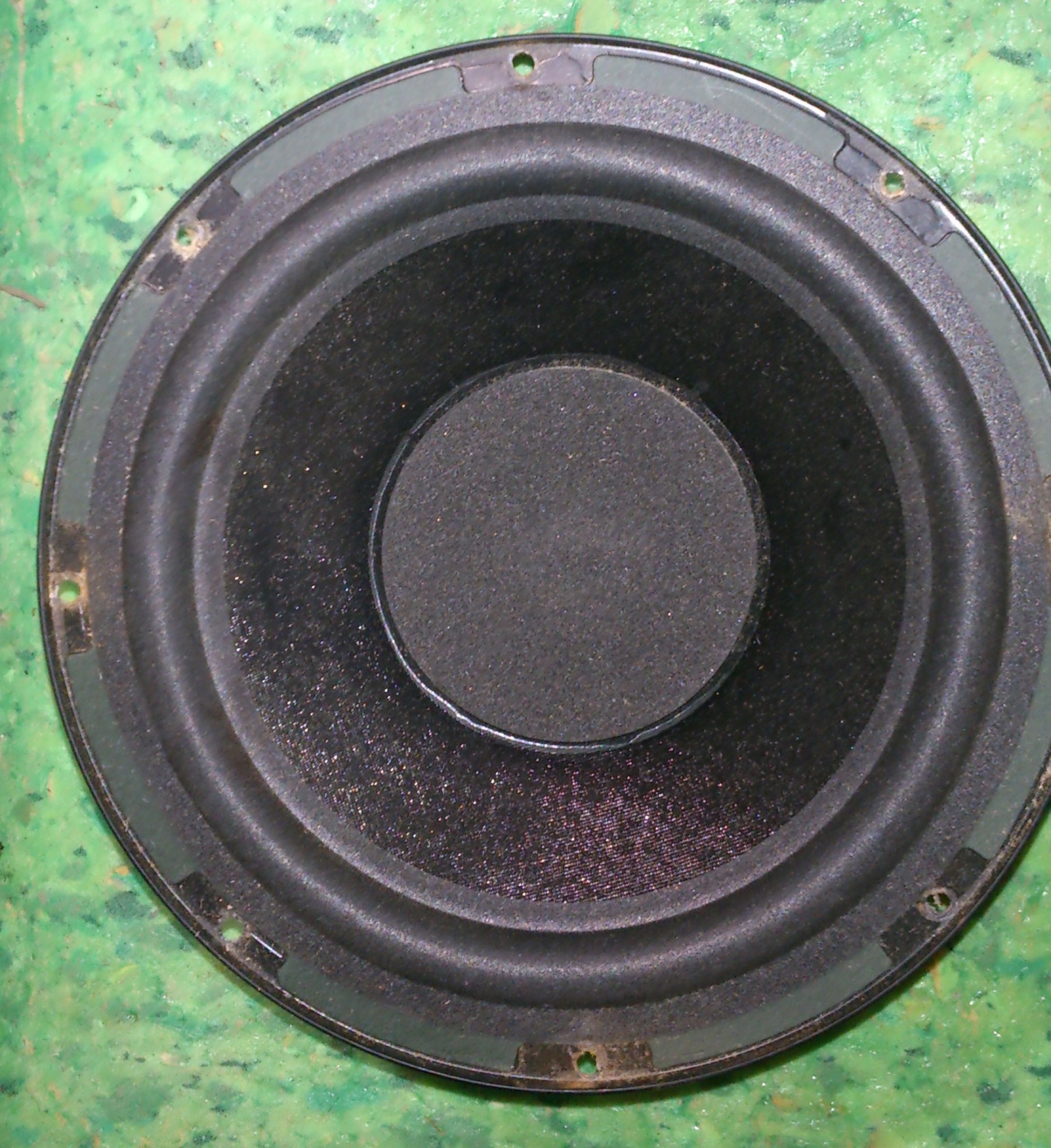

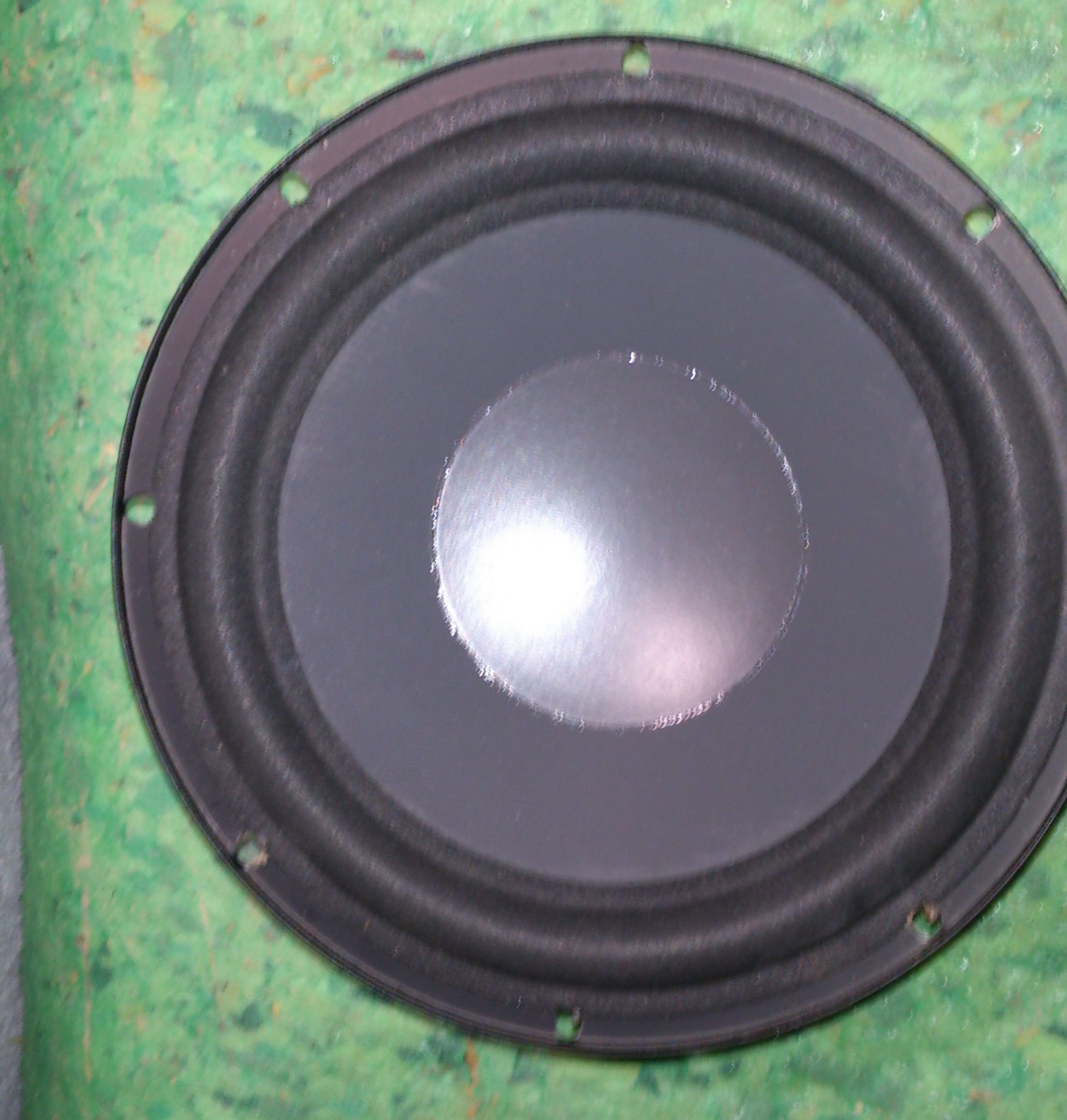

If I was to SHOW you two drivers & you had to pick one - what would you choose? Both drivers are 8" and salvaged from ported cabinets with less than 20 litres.
In the RED corner: weighing in at 75w RMS is the JVC boasting just 3 ohms of resistance.
In the BLUE corner: The mighty Soundware XS driver. 100w of RMS power, more Xmax, champion 6 ohm driver.
You can have either for free
Which?

The physical (visible) characteristics of a woofer/mid-woofer could give certain hints about its performance.
Further, for a disassembled woofer, the height of the voice-coil together with the depth of the gap can indicate Xmax capability, linearity (fidelity) and efficiency. The presence (or lack) of demodulation rings, magnet structure etc. can also give some hints about distortion performance.
Hope that helps.
- The surround material (PU, cloth) and bends (roll, accordion etc.) indicate suspension compliance, excursion, linearity etc.
- The cone material (paper / pulp / other), shape (straight / curvilinear), depth and reinforcement (ribs etc.) indicate certain breakup tendencies (or lack thereof) and application (sub / 2-way / 3-way).
- The size of the voice coil, basket material (aluminium vs. steel) , presence of vents etc. indicate thermal handling.
- Magnet type - Ferrite / Alnico indicates midband distortion characterisics
Hope that helps.
Subjective tests done: 16l ported.
The JVC proved slightly louder - I guess 3 ohms will do that. Bass response was warm and smooth.
The Boston Acoustic drivers delivered more punch, more deliberate, more dynamic on the kicks. It's response seem faster if that's an actual thing.
I've learned nothing substantial. At reasonable listening levels the JVC wins by the slimmest of margins but pump up the volume, the Boston Acoustics driver gets to strut its stuff, easily outpointing its counterpart.
