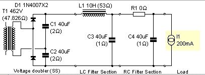

LCC design with these capacitors throughout: 80uF 500vAC motorstart caps
C1 is comprised of two of those motorstart caps in series, so is C2, four caps in total just for voltage doubling, does voltage doubling take kindly to voltage deviders parallel to each cap? or is this another wild goose chase?
If so what is a good value for this design? I'm not experienced enough to calculate it myself.
C3 are two of those motorstart caps in series, so is C4.
I know I'm not anywhere near experienced enough to design something so dangerous, but I can't help just fumbling about with theoretical designs.

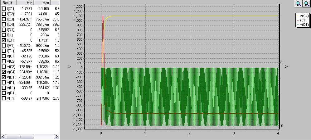

Check out what PSUD had to say anyway:

Is there a suitable source for the choke?
I need about 1.2kV minimum, 1.5kV preferred max DC voltage headroom of the choke and preferrably about 50-150 ohms resistance.
I can easily pull down the final voltage just by choosing another power supply transformer, Sowter can help out here with their vast selection of fairly small voltage increases in all their models. ie, one model is 320v, another 340v, another 360v and so on.
I just need a choke...I could use a hammond with a 1kV limit but that limits me to about 850v, I wouldn't mind going up to about 1.2kV.
Still too much voltage variation on C4 to call it perfect but it's pretty close.
130mV on C4 with 7mA.
You are having quite a conversation with yourself.
Why? 100 ohms 200mA is only 20V drop, quite negligible in the face of 1,000V. Either pay a whole lot for the choke or wind a slightly higher transformer to cover choke loss: simple economics say you probably want about 10% loss in the choke. The extra 100V from the tranny is cheaper than a low-R choke.
Put the choke in the ground leg. That requires a little better insulation in the transformer, and the first caps, but the choke insulation becomes unimportant.
1,000V at 200mA, 200 watts.... what are you going to build????

Add capacitor input, this then keeps C3 and C4 as 40uF but adds C5 and I've seen beneficial results of 20mV ripple with C5 as 220uF, making C5 the only electrolyctic capacitor in the entire power supply and lightly loaded at that.

You're right it is dangerous especially without any CT, I've still got to research how to properly ground this amp, one step at a time I don't want to muck it up.
For better voltage regulation...
No reason at all, care to refer me to documentation on this matter?
The initial idea was to series two chokes for more inductance, I would therefore need all the regulation I can get.
Avoiding the use of a further RC stage.

I believe even 100mV ripple on 1200Vdc for the 813 SE amp is acceptable.
If it is a 10k to 8 ohm OPT, the hum voltage at the output would be extremely small.
In case you really want to get absolute no ripple, you may add another L-C filter.
Make sure that the capacitors and chokes you use can stand at such high voltage. You may find chokes which can stand 1.5kV/ For capacitors, you probably need to put two in series.

C1 and C2 need to be big. Way big. Fanarkalingly big.

Indeed but the cheapness of this power supply quickly fades as you add another choke, if you wanted to though you could easily add a second LC filter and change both L1 and L2 values to 1 henry, this will give quite good results.kmtang said:I believe even 100mV ripple on 1200Vdc for the 813 SE amp is acceptable.

The caps are rated for approximatley 1400vDC or 1000vAC, the choke I'm hoping is rated for 1.5kV but I'm not holding my breath on that one.
Sch3mat1c said:C1 and C2 need to be big. Way big. Fanarkalingly big.
Tim
Yes the capacitance in a vdub is directly related to the amount of current available for the load, at about 60uF and below, then voltages begin to sag for 200mA.
We can take advantage of the fact that voltages are half at C1 and C2, so we don't need a 1.4kV capacitor, not even a 600vAC capacitor, the capacitors I've selected will do just fine by themselves for C1 and C2 with a max voltage of 500vAC or 700vDC!
So C1 and C2 doesn't need to be two 80uF 500vAC caps in series, they can be two 80uF 500vAC caps in parallel, or 160uF each, or more.
The final tally is, C1 = 80uF 710vDC, C2 = 80uF 710vDC, C3 = 2x 80uF in Series for 40uF 1400vDC, C4 = Same as C3.
