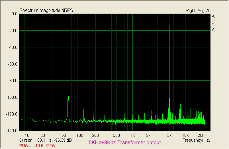

I did promise to post some FFTs of the DCX. Here they are.
Background. Tho many folks say "the stock DCX2496 sounds just fine to me" I never liked it. Not awful, but it would get on my nerves after awhile, grate on me. But why?
So I ran quite a few tests on the stock DCX output circuit vs a transformer only output circuit. I believe the 2 graphs below show very well what I was hearing. The stock output generates a lot more harmonics up high - and even some subharmonics. The transformer does not. No musical signals were harmed during this test.
