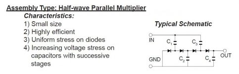

Mayday,
You did say preamp. Instead of a doubler go to a 3X or even 4X 1/2 wave parallel multiplier. You will surely have enough headroom to regulate the rail for the hybrid 6SN7 circuit I've uploaded. Use the Chinese power tubes as pass elements in regulators (1/channel).
