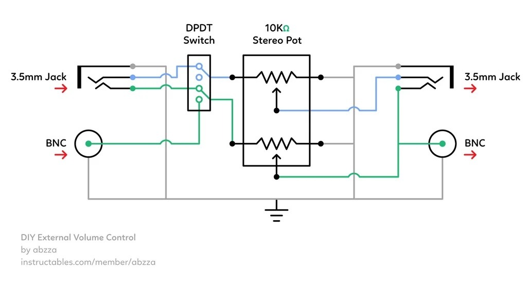

To clarify what I want to do, I attach a schematic of a project that I found online but I want to make multiple changes. First of all I will to change both inputs to RCA and I will use one RCA and one 6,3mm Jack as output. Then I will insert another switch so I can choose my output.
In the end I want to connect my monitors wich have balanced input so my first idea was to go from the RCA out to a stereo DI box and then in my monitors but now I am thinking about having an inbuilt DI. In that case I would change the RCA out to two XLR out.
As I understand it I would need two transformers for this. Do you have recommendations? Keep in mind that money is limited here so I want it to be cheaper than a Stereo DI I could buy. Lets say 70€

Probably cheaper than transformers especially if you can steal power from somewhere:
