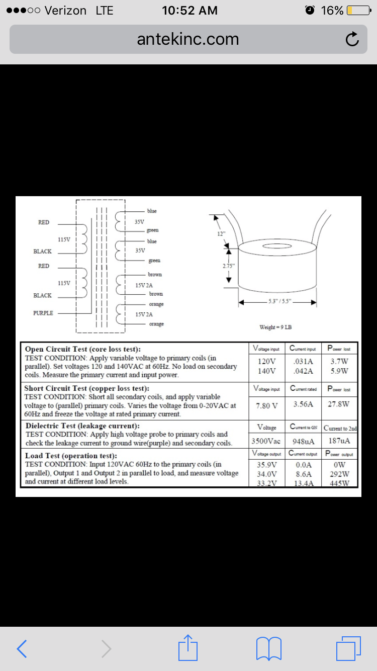

Any transformer under no load will give more than the advertised secondaries voltage. Under a very big load that voltage will drop , sometimes more than the advertised voltage. But after rectifying the dc voltage will be around 1.4x the secundaries voltage, regardless of the load.
Am I wrong?

Wow, a 180 degree change using the edit button. Well done.
55VAC @ 1000VA is the transformer rating. It has to deliver this or it is in default of its specification.
What you are arguing about is called regulation. 40% would be terrible for transformer regulation.

where did you get the 40% transformer regulation?
"The voltage regulation of the transformer is the percentage change in the output voltage from no-load to full-load."
