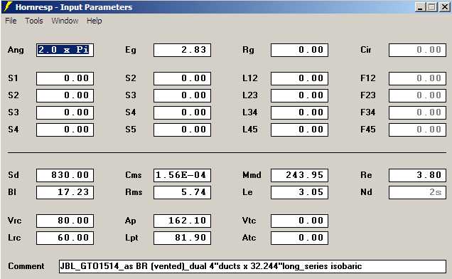

I'll attach a Hornresp Input screen for an isobaric bass reflex (two drivers in series). V_net=3.3ft^3. By the time you have the isobaric configuration, bracing, etc. accounted for you might be around 5ft^3. A simple trials box could be build from 2'Dia. sonotube, some like the sound of isobaric boxes, some don't, so some experimenting may be in order. Another possibility would be bjorno's T-TQWTs.

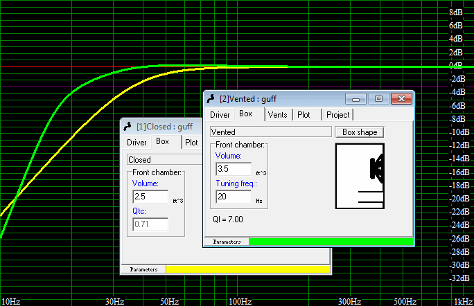

Two 3.5cuft (clamshell) isobarics tuned to 20Hz are not too shabbly.
(6 cuft and 20Hz will give you flat to near 20Hz and a very sharp
roll-off, which is not good transient wise. The smaller box has a
more rounded roll-off, better for transients, and generally the
smaller boxes airload will better linearise the driver distortion.
4 cuft and 20Hz gives you -3dB @ 20Hz isobaric.)
rgds, sreten.
Placement just over 1/3 along the back wall and just over 1/3
along the furthest side wall usually gives the best overall result.

Hi thanks for the replies and sorry for the delay in responding . Been working to many hours and then catching up on some much needed sleep .
I don't have my heart set on isobaric enclosures , if anything I'd prefer four seperate enclosures of 2ft x 2ft x 2ft maximum outer dimensions so I could spread them round the room . The reason I thought isobaric was all the builds I could find were using 10cft per driver .
I do have suggestions of two sealed ppsl enclosures of 6cft and a simple transmission line for each subwoofer , length 2.3m , open end 0.042m2 , close end 0.249m2 .
I've no experience of either ppsl or transmission line and have only heard one clam shell isobaric setup in a car once .
Good to hear that both of your designs come in under the size I need to adhere too . I will Google the bjorno t-tqwt's as well . Lol been looking for a supplier of sonotube in the UK for ages without any luck , I've stacks of old mdf to knock up some trial enclosure though .
Sreten , what's the port area and length on you design please?
Thanks for your time
Steve

Since you seem to have an almost square room (5m x 5m) that is also half wide high (2,5m), you will have pretty strong room resonances to deal with. You don’t seem to care much about high output. This info considered I wouldn’t go for a resonant system but ‘simple’ closed boxes with compensation EQ. That way you can keep them relative small and ‘spread them round the room’ to deal with your room resonances. If you don’t use more than 150Watts per driver you don’t even need a low cut off filter and you should be able to get 110dB at 20Hz and about 99dB at 10hz without room gain from four 100 litre cabs (3.5cft) and 600 watts total. These figures are based on 3dB system losses. That's all well within your requirements and enough to upset someone. Of course you can also build 100 Litre basreflex (+ port volume and driver volume) cabs and 'fill' the tubes completely to see what you prefer:).
The choice between isobaric or not is essentially two boxes of a given
volume (say 2.5 to 4 cuft) or 4 boxes each double the size (5 to 8 cuft).
The 8 times the volume increases max SPL and efficiency by 6dB for
the same bass extension. Essentially isobaric gives you two 87dB
drivers with half the Vas sutable for smaller boxes.
IMO if isobaric goes loud enough, here it is your best choice, as you
will have converted some car subs to parameters more typically
used in domestic subs, but its your call.
A big room with efficient speakers might need the extra SPL.
rgds, sreten.
Port sizing of subs and speakers is a contentious issue. IMO
they are often oversized compared to what you actually need
for typical programme material rather than test signals.
4 cuft tuned to 20Hz is a 4" diameter x 18" port acording to WinISD.
(or a slot 15"x 0.75" x 13" deep). Flared ports complicate matters.
