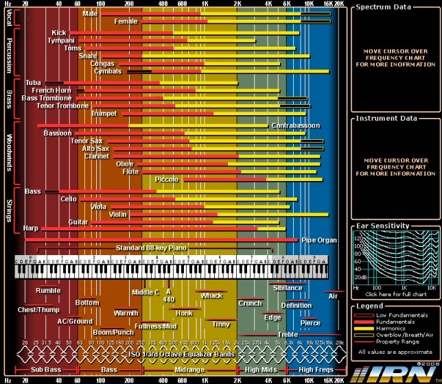

I have been following this chart...
Sub bass 10-60 Hz.
Upper bass 60-250 Hz.

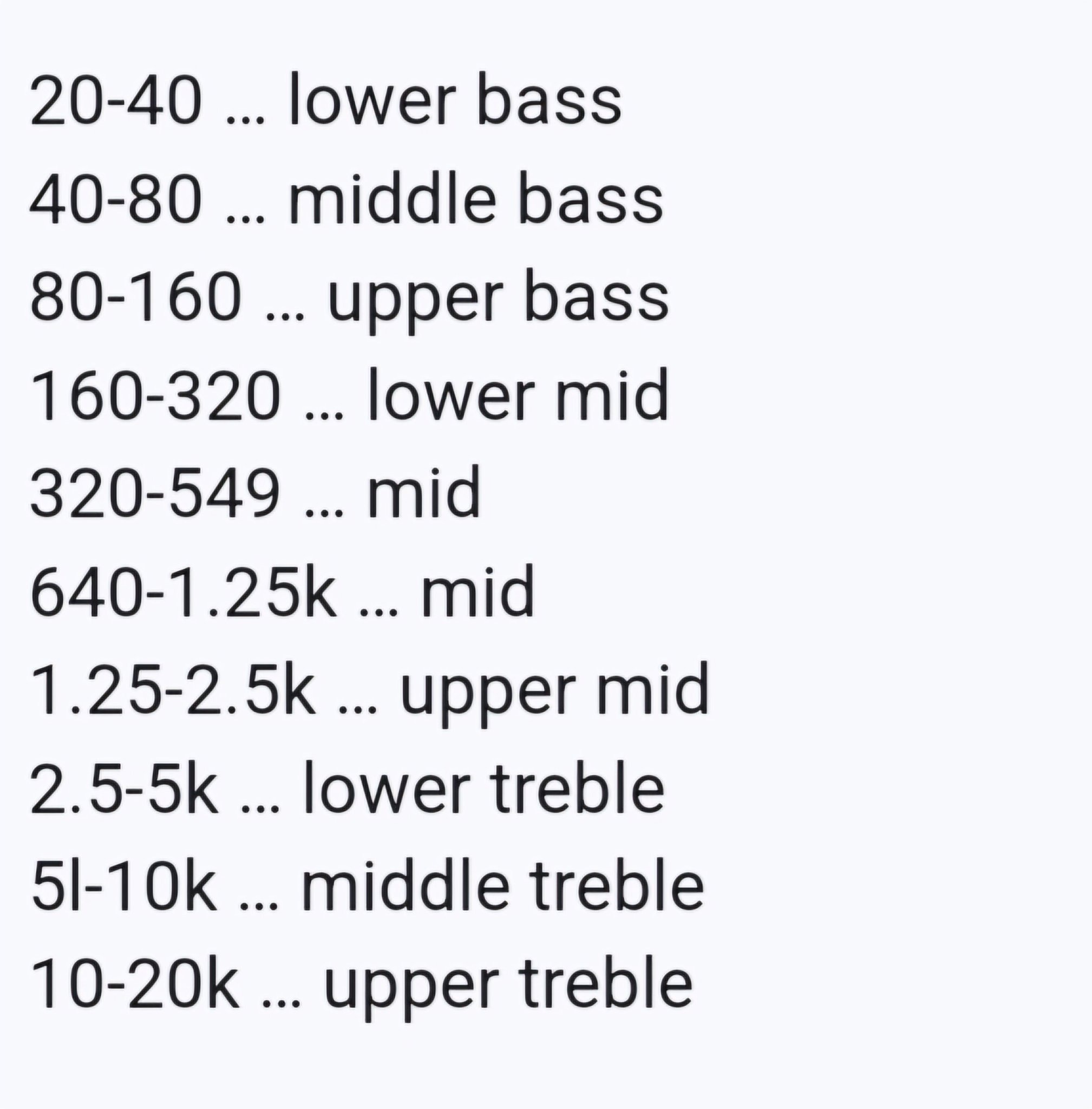

The one i go by is octave based,
20-40 … lower bass
40-80 … middle bass
80-160 … upper bass
160-320 … lower mid
320-640 … mid
640-1.25k … mid
1.25-2.5k … upper mid
2.5-5k … lower treble
5-10k … middle treble
10-20k … upper treble
dave

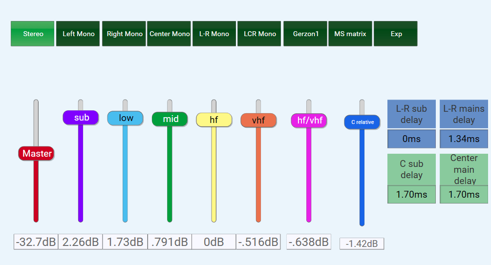

It is very easy for me to mute any driver section, solo any driver section, solo any LCR speaker playing stereo summed to mono, play stereo, or matrixed LCR.
Each LCR speaker which are the same, also has the same sub underneath it.
So it's easy to discern things like a sub's concussive force alone, or whether multiples add for more force, or whether a track has mono sub or stereo sub content....etc.
Highly recommend a setup like this for sheer playing around/learning/experimenting..., my2c .🙂

Interesting that chest thump is at 25, boom punch is at 125, and whack is at 1,250. I’ve always thought of those sounds as being part of a wideband sound. I’ll get some noisy recordings out today and listen through an equalizer.
Also, I think in contra bass, bass, tenor, contralto, alto, mezzo soprano, soprano, … Classically trained I guess.
