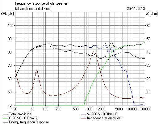

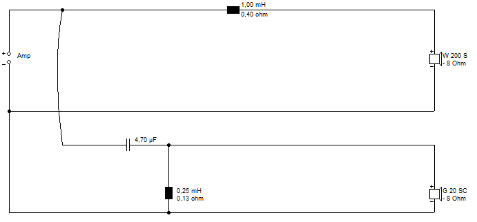

Here's a hugely popular speaker that sold by the truckload on the 1980s. The Celestion Ditton 15XR.
I even have the crossover for you, slightly upgraded with an MKP cap from the non-polar original. 🙂
I never thought much of these budget jobbies, TBH. I was listening to three ways by then. They were harsh on the midrange, though you'd think they were OK if you'd never heard better. The modelling shows why.

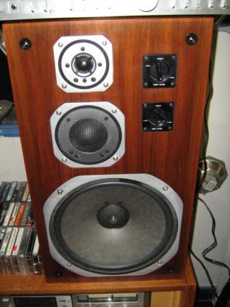

Yamaha NS-690ii...another sleeper IMO...superb craftsmanship without the insanely bloated price of the later big brother NS-1000s...and for some inexplicable reason superb with my low-power SET amps.

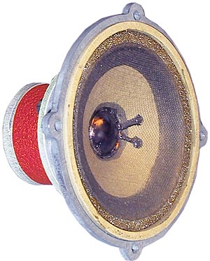

with a 3" cone tweeter running off a single capacitor
Whardale had something similar -- W60 -- if you can find one with good surrounds (or resurround them), these are fantastic devices.

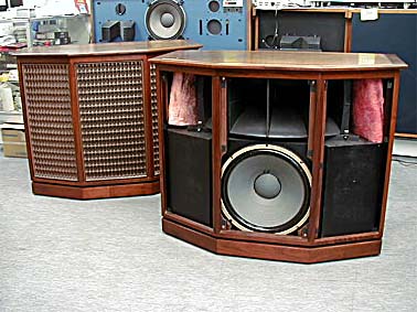

I was quite taken by the Altec Barcelona's my next door neighbor had.
The midrange was very pleasing. He sold them for nickels. My girlfriend didn't want such huge speakers or I'd have been all over them. The woofer surrounds were shot though upon inspection at the time of sale. He bought some high dollar (euro's actually) new speakers (slim towers, can't remember the make) but they couldn't match the midrange of the Altecs i.m.h.o.
