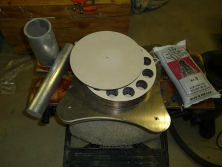

kilowattski said:I had alot of help from Vinyl Addict as I am a rookie machinist.
Look familiar? 😉
3 layer 50 pound platter magnetically levitated replaced the acrylic platter last year. Mylar tape driven of course.
BTW, Nice job on your table.

Frank,
Yours is much much nicer than mine. Mine kinda looks like a cheap imitation compared to yours. Being totally honest, I would have never known where to start if it were not for your advise. I owe you big time for your help. BTW, the SME IV works well with the table. My arm pod is not as elaborate as yours. The next mod is an inverted bearing (I will purchase it because the machining is way over my head) and new platter. I have no idea what the platter will be made of yet. Again I wanted to publically thank you for your help, many, many kudos to you.
Hi, OMA has a solid ‘slate’ product that they produce from an old mill in Pennsylvania, they use a computerized water jet system to cut the design. Currently they are making plinths but no platters though they can produce a platter to spec and also have a diy forum thread that focuses on slate TT and platters.
I started to play around with a platter design awhile back. Jonathan (the moderator) suggested two .75 thick pieces of slate with a core to bring them together.
I love the look of the slate and can envision a slate plinth plus slate platter. I attached a .pdf file of a design I started to play around with for a slate + core + slate sandwhich platter to see how it would look. This was before the Teres bearing I got. I am now thinking of a design that would be a .75 slate + .75 (stainless or?) + .75 slate.
I hope to get back to this soon but everything in life has been pulling me away from it lately.

attached is a pdf file that can be 3D activated, if the attachment does not work I’ll upload a pic. The Alibre background is dark, if you click the background color tab to a lighter shade it is much easier on the eyeballs…

Vinyl-Addict said:
Look familiar? 😉
Stellar job, nice and clean; impressive indeed!
Can you elaborate on your mag lev design?
1. How did you address strong magnetic field on the platter surface?
2. Did you notice the bearing noise floor drop? I'm asking because magnetic repulsion nullifies the bearing thrust plate interface load (big load on small surface), but in the same time inevitably introduces side load applied to the plateer magnet due to two mag fields concenricity anaccuracies (small load on large surface), which also causes tilting moment if applied not in the middle of bearing shaft.

#1- I have no issue with mag. field at the platter surface. The bearing is buried deep inside the plinth. You would have to see it first hand to know just how it is located.
#2- The bearing is slightly quieter with the bearing "floating" without a thrust bearing, but to be honest not as much as I had thought it would have been. I decided to modify the bearing to initiate very minimal pressure contact with the thrust bearing because I was not positive that the magnetic spring induced by floating the bearing was a positive thing. My finding was that I like the performance better with minimal pressure on the thrust bearing. Upper frequency response specifically is better, IMO.
There is also no problem with side, at least in my bearing. I went to great length to machine the pockets for the ring magnets to reduce "cylindricity error". I also measured both runout and vertical movement of the bearing when I had it floating and measured 0.002 max. vertical motion. Now this is due in part to the actual platter having very small deviation so I was quite happy with the results in both runout and vertical movement. The strong ring magnets when postioned in repelling fashion close to each other create a very tight spring, extremely difficult to push together the closer they become to each other, but as I said, I prefer the bearing to be seated with minimum pressure rather than float.
Did you measure magnetic field at the record plane?
I've played with a pair of 3" magnet rings placed 4" below the surface and had 20 gauss max close to the spindle. I was not comfortable to keep my MC cart playing in such invironment. I also tried to isolate is with three layers of mu-metal; it didn't help much.
