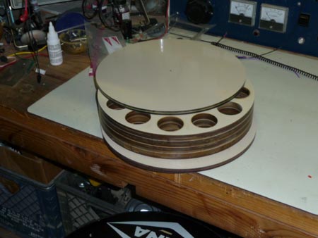

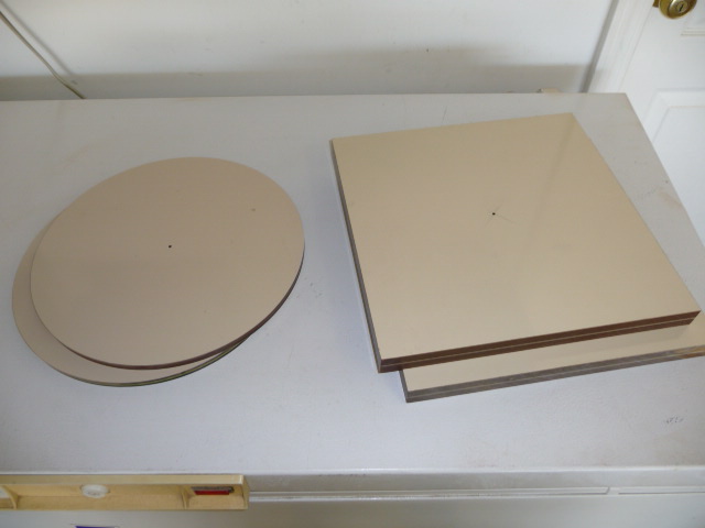

Here is what I am using it is a paper impregnated phenolic. It is available in various thickness. I went with 2- 1'X1'X3/8" and 2-1'X1'X1" square blanks. I bought them from http://www.polymerplastics.com/composite_xpc.shtml, but this site has them as well and a good spec on the product http://www.sdplastics.com/phenolic.html.
Bill
Bill
Here they are after machining, I used a router with a circle cutter and a hole saw. While the material is quite machinable I dulled my router bit and hole saw. The good news is it has a high melt point so it makes machining easier than plastic. The supplier I purchased from does offer CNC machining and I would recommend it as you are looking at about 6-8 hrs work, but my labor is free. I did quite a bit of research on glue to bond these, the problem lies is you cannot fuse this material. It is so inert they use it for lab bench tops. Phenol glue is what is used to glue plywood together. The best product I was to determine was Loctite Black Max 380 it is a Toughened Ethyl. I put one drop on a couple of scraps and allowed them to dry 24 hrs to dry. I was unable to break them apart.
