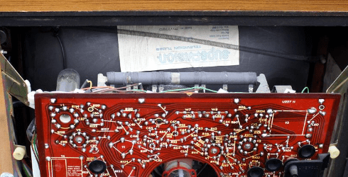

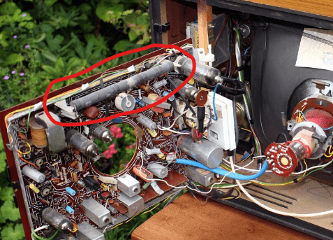

Before my time but those kind of multi section droppers were common in old valve TV's, in fact everything you show could be from a field engineers kit back in the 70's
I've seem them in these TV's, am I that old...? 😱were common in old valve TV's
Hugo
OMG, that TV is infested with components, it needs some treatment before it spreads to other devices.
