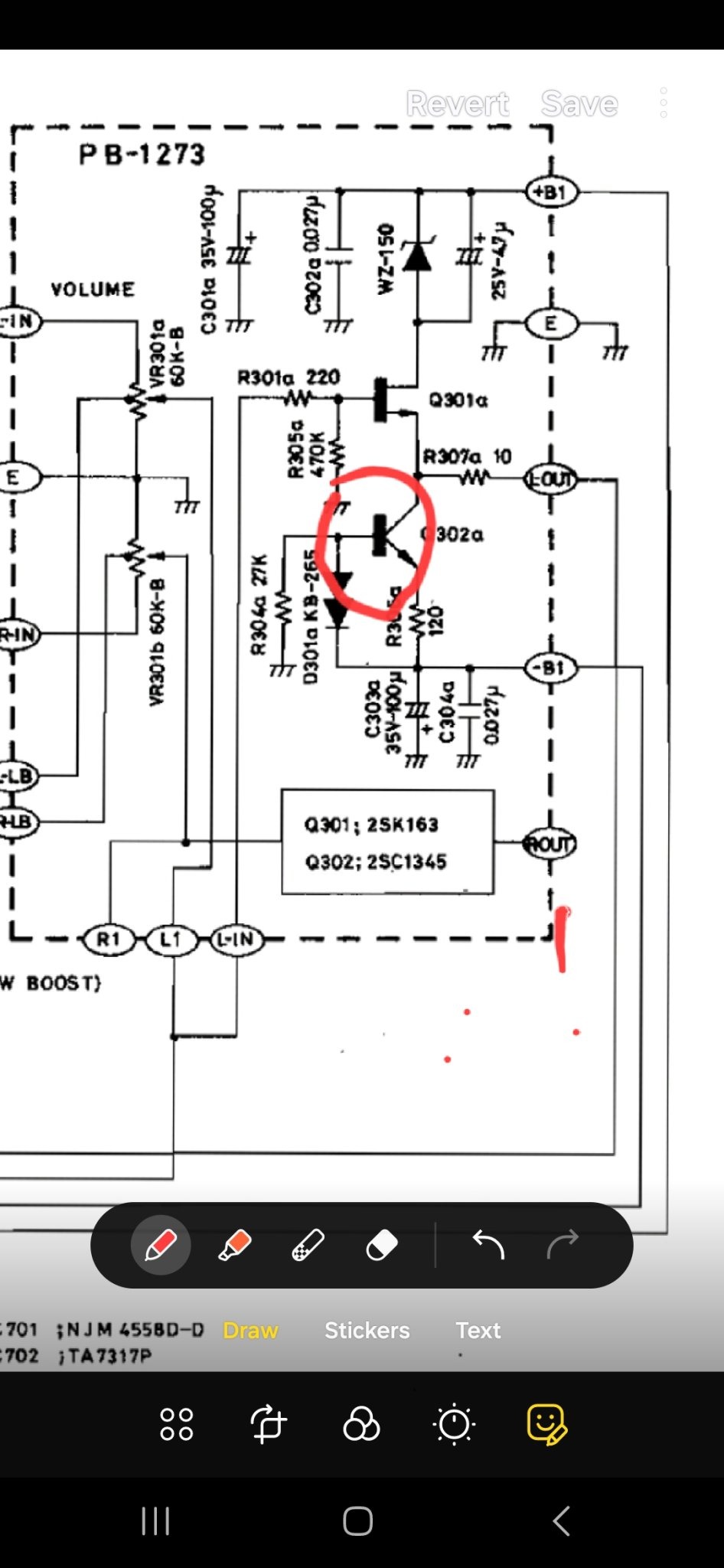

With this next transistor Q302a, is this again a constant current source? If it is does gain matter? A quick calculation shows that current over the transistor is ~300ma is this correct?

300mA is definitely wrong.
You can find out exact current by measuring voltage drop accross 120 ohm resistor.
300mA would burn the input fet. More like 3mA is realistic.
No. Even high voltage low gain transistors work as current sources. Here the voltage on the base is fixed at 1.2V by the diodes. The Vbe drop on the transistor is around 0.6 V so this leaves 0.6V on the 120 ohm resistor, so there should be close to 5ma flowing through this current source.
Looks to be about 7ma if those are ordinary silicon diodes on the base of the transistor below. It seems to be an emitter follower. More Hfe here won’t do any harm as it will increase the drain load impedance of the fet, but I’d think any common audio transistor would be ok here.
