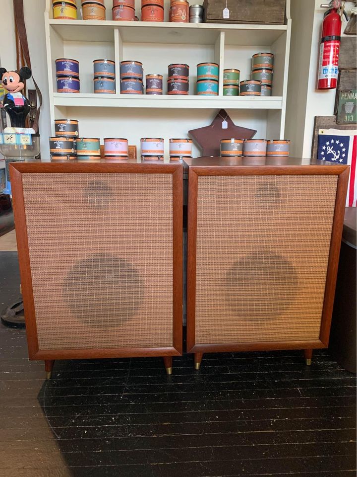

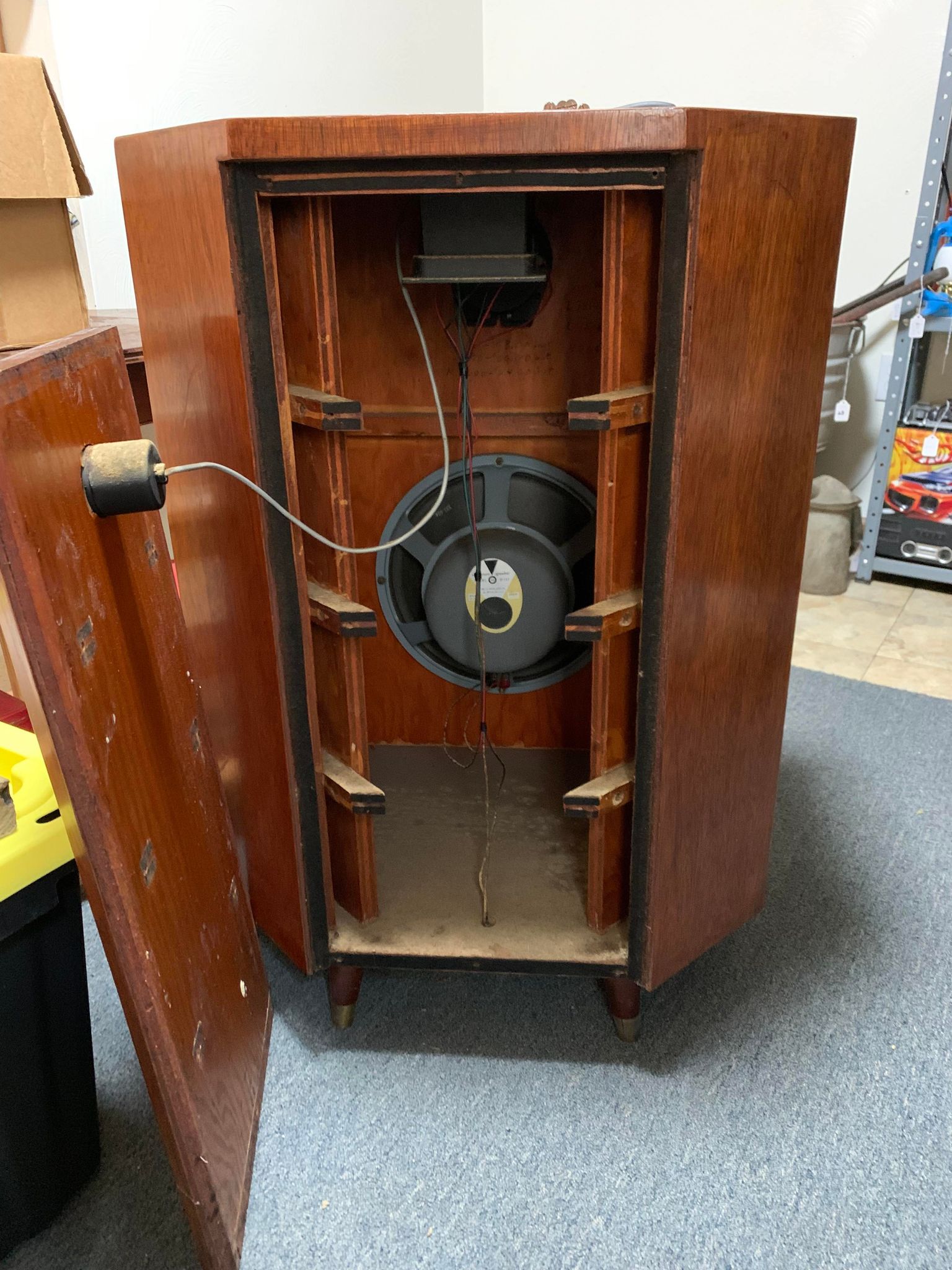

What are these drivers worth?
Should I purchase? These are for sale locally for 950.00.
Looks like a DIY Jensen bass reflex cab with JBL drivers and crossover.

First off, if you need to repair any of the drivers, JBL is not offering current repair parts. There are aftermarket repair parts available.
However you can buy copies of the bullet tweeter and 12" woofer for $140.00 and $125.00.
Then there is the minor issue of the 075 bullet tweeter crossover frequency of at least 2,500 Hz. The woofer is good to no more than 800 Hz. to maintain coverage.
The one of the main problems with old woofers is that the spider stiffens over time, particularly if they haven't been used; As far as I know, no one has come up with a satisfactory solution so far, except perhaps a complete re-cone, if available.
