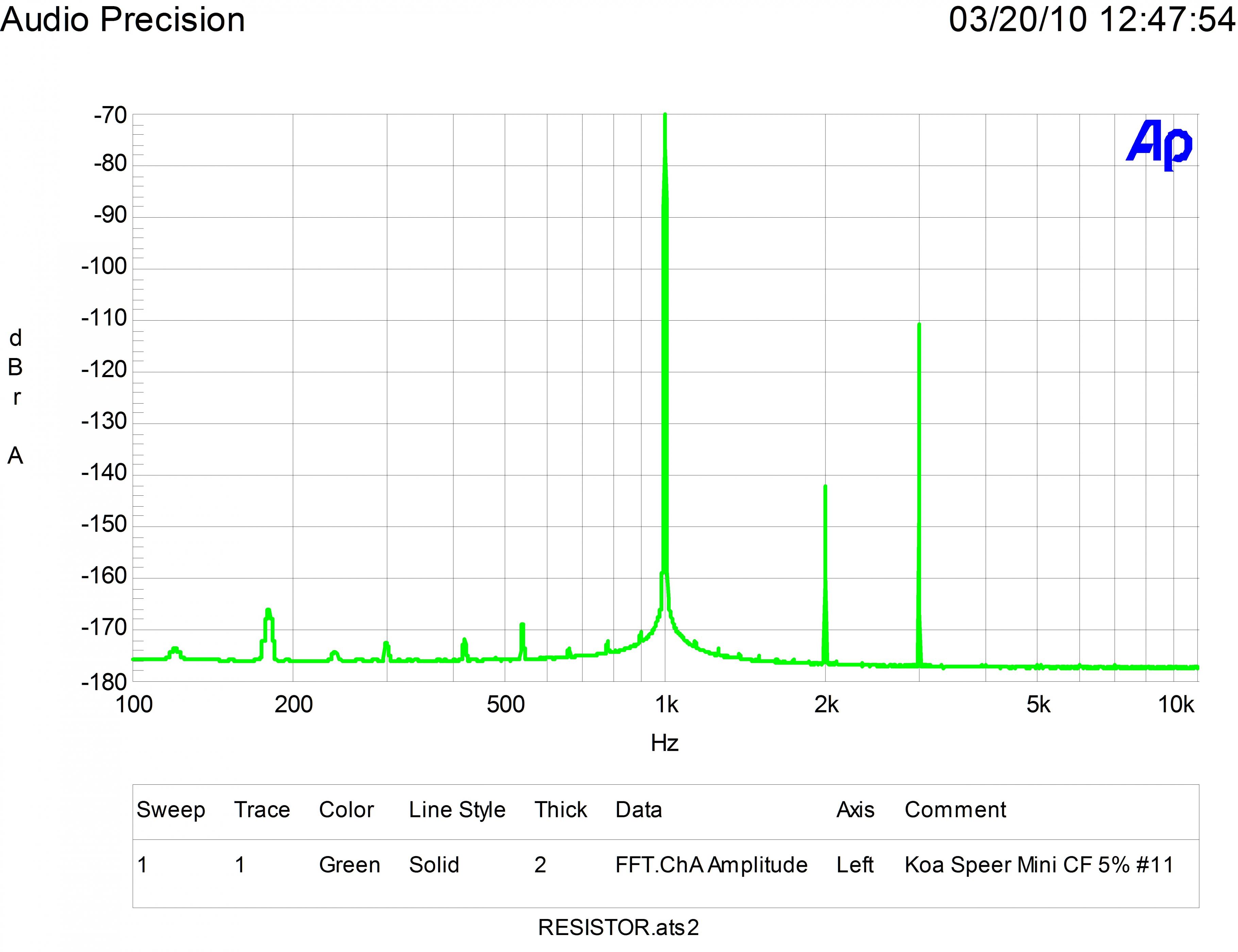

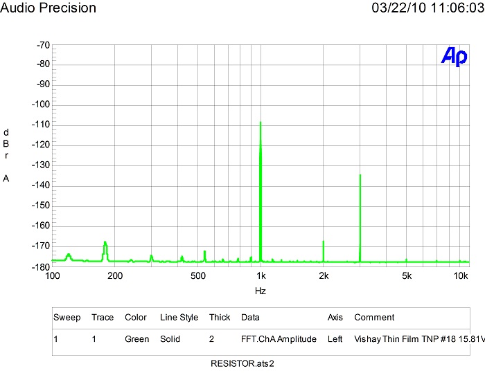

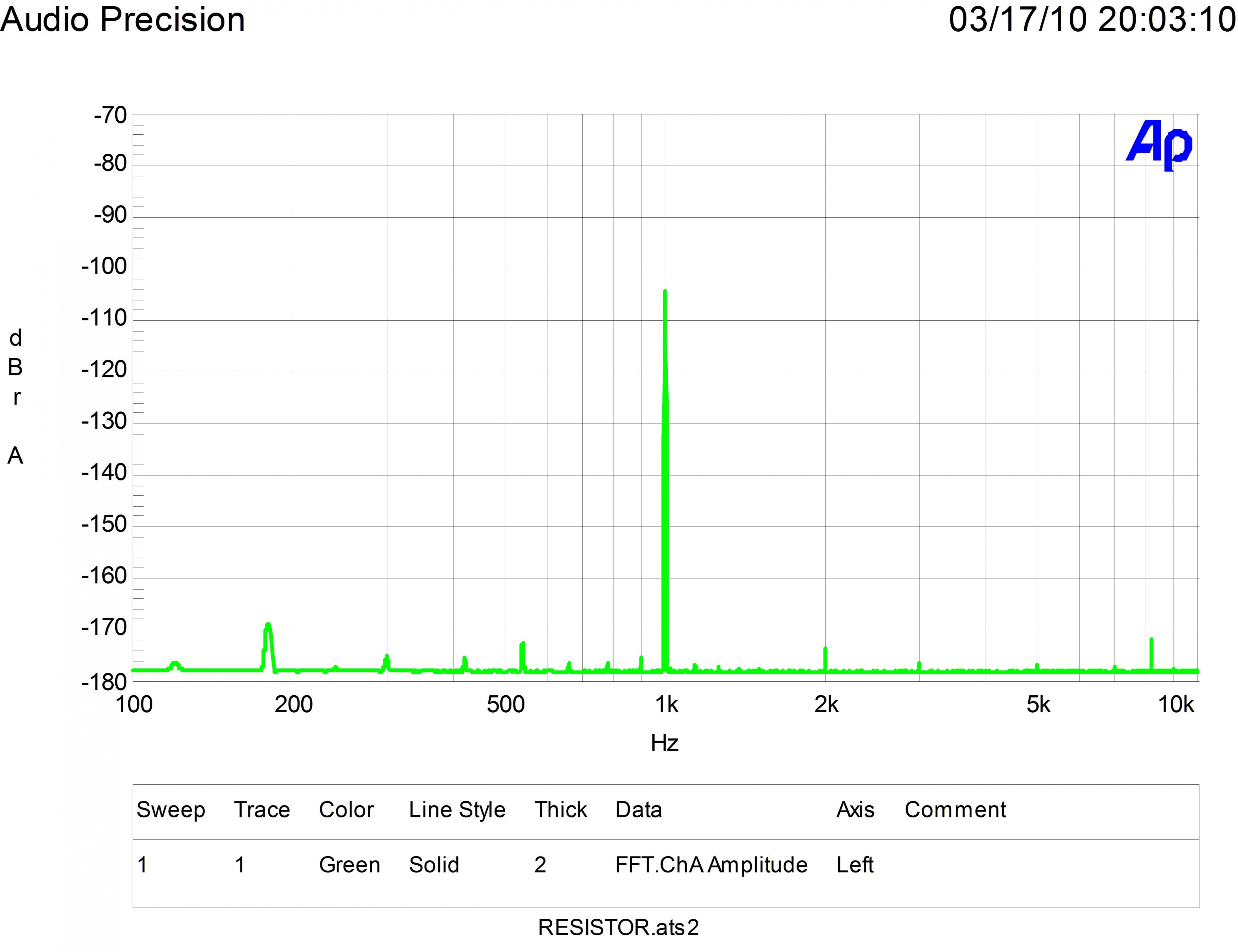

Low temperature coefficient is nice as that reduces odd order harmonic distortion. Even order distortion is a sign of very bad resistors. So of course some folks prefer that sound, as even order distortion masks other bits of bad stuff. Also adds a musical richness to sounds, although that is in the end coloration. As to the artistic effect of distortion ask any fan of Pablo Picasso!
Now using a resistor at a fraction of the power rating reduces distortion, by reducing temperature rise. In some resistor types it also lowers noise. However noise is not as large a concern in properly designed equipment. The major exception is the input stages of low level preamps, such as phonograph preamplifiers.

For thumbnail ID just mouse over the image. For those who haven't seen these measurements before, the test excitation is 1,000 hertz at a level of 0 dB reference and suppressed by the measurement technique. 1,000 ohm resistors shown are tested at a small fraction of rated power.
