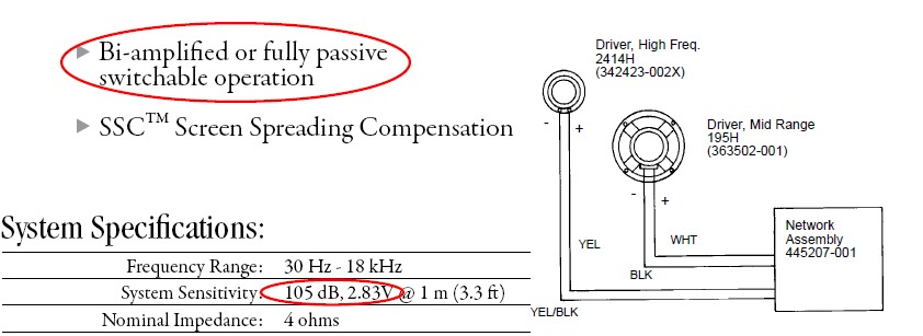

Not at all, the entry-level 3-way speaker JBL 3730 cited earlier is capable of passive operation (see picture below). And at 105dB/W, it's 15dB more sensitive than the average domestic speaker, it could very well be run from an AVR if desired (yes, that's true).
I did not want to argue with you earlier or overload you with information, as you appeared to be already overwhelmed by what was being posted in the thread. I cited such speakers only to tell you that you're in the commercial (business) price zone, and not because these speakers would actually fit in your room.

If you want to get both Amp and DSP for 3-way for under 60k, you would have to start considering car amplifiers like Sony, Pioneer etc. along with a 6-channel DSP like DBX Driverack or Behringer Ultradrive, as already mentioned earlier.Aha and I was considering 60K DSP+AMP combo for speaker pair.
Cool so we can purchase passive crossovers fir it. Please do list a good one. Will definitely look into it.Not at all, the entry-level 3-way speaker JBL 3730 cited earlier is capable of passive operation (see picture below). And at 105dB/W, it's 15dB more sensitive than the average domestic speaker, it could very well be run from an AVR if desired (yes, that's true).
Purchase? The network goes under the mid-range bracket. If you're very interested in knowing more, see the attachment below. After assembly, the speaker arrangement would be approximately 6ft tall, making it overkill for your kind of application. You would do much better picking up a design, such as the one mentioned by Vineethkumar01.
