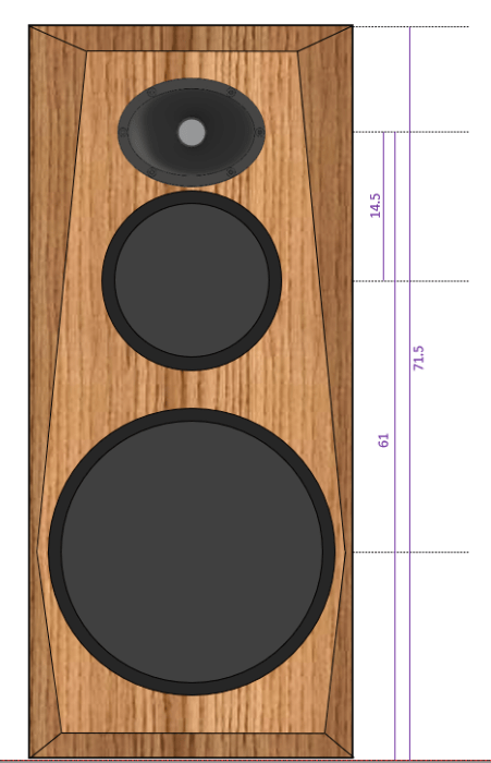

If you are still interested in building 3 way active the speakers, you can consider a project like below but an active version of it.
http://www.troelsgravesen.dk/Faital-3WC-10.htm
You may change the box that holds drivers from the plain cuboidal version shown in above project to one with chamfered/rounded baffle or one like this:
(Pic courtesy: member @nanou64000 . Taken from post here: https://www.diyaudio.com/community/threads/a-3-way-design-study.376620/post-6805122)
The 10inch 10RS350 can be got from below or similar other places where Faital pro drivers are available:

cost of 2 drivers = 2*11k = 22k
Since the 6RS 140 Mid is hard to get, you may consider this:
https://www.mdrelectronics.com/ProductDisplay.asp?PID=28991
cost of 2 drivers = 2*6k = 12k
For tweeter, I would have used a compression driver like this one: https://diyaudiocart.com/SB-Audience-Bianco-44CD-K-Compression-Driver-1? search=audience (or the PK version of this driver) on a 3D printed horn with the horn design generated using the ATH software or any other commercially available horn suitable for a driver like this.
You may use an SB26CDC tweeter with/without a waveguide (5ich waveguide can be 3D printed for this driver. Take one of augerpro's design's if interested):
https://www.audiofy.in/product-page/sb-acoustics-sb26cdc-c000-4-26mm-ceramic-dome-tweeter
cost of 2 drivers = 2*5.6k = 11.2k (without waveguides)
Total cost of drivers: 22k+12k+11.2k = approx. 46k

Now if you really want to do speaker design well, at least to some extent, also invest in a good measurement mic/setup either like the MiniDSP UMIK-1 or Dayton EMM-6+soundcard

I didn't understand the difference between enclosure modeling and enclosure designing you mentioned. I am assuming that with enclosure modeling, you mean the box modeling for box volume and bass alignment (sealed/bass reflex, something else) computations. VituixCAD can do this. In addition to box modeling, it can do baffle diffraction simulations with drivers in it, crossover simulations with proper directivity, power response and all sorts of other useful and important information, box size caused internal standing wave mode computations, and a whole lot of other functionality. I mean, it is so comprehensive that the applications of that software is just limited by one's imagination, level of knowledge and use case involved. There are a set of videos online which shows how to use the software. Once can then also read the manual
This helped me a lot:
The software is different and easier to use one (BASTA). But the principles involved in design are the same. So these days I use only VituixCAD.
By enclosure designing, I am assuming that you want to draw the box in 3D with required dimensions? If so, I personally use fusion 360. It is free for student/hobbyist license or one of those licenses. You can figure out if interested.
Have you designed any crossovers before? If not, to design a proper crossover, you need good measurements. With the actual drivers in its intended box or a prototype box. VituixCAD can be used to its full potential once you have angular frequency response data captured using a calibrated mic + soundcard (with provision for loopback) setup. This will help one understand the intricacies involved while tuning the crossover. Otherwise also, with a bit of guess work/more knowledge about driver behavior and its interaction with crossover and the overall construct, one can arrive at reasonably good crossovers if not the best optimized ones. But that may require a level of knowledge that you or I may not have at the moment. So let's leave that to the Pros. I have used Dayton EMM-6+ESI U86XT (6 output) soundcard and a small turntable set up to get quasi-anechoic measurements for different angles. You can see all this in my 3 way active speaker thread if interested. I also use the same soundcard+ Equalizer APO software on my PC to implement the DSP crossover. It has worked really well so far.
What kind of frequency response curves you want to achieve as target depends upon your tastes/experience etc. Generally followed practice is avoid abrupt transitions in directivity/power response etc and aim for smooth transitions all around. Since it is a DSP crossover, it is very easy to dial in the crossover. Hear the speakers and modify it if needed. But that part is much later in the process and is not your worry now.
If you really intend to continue with this project, get a box modeling software, come up with alignments for drivers you are interested in as the first thing, post here, ask questions and learn. Then you can go to crossover.
Sorry, but I cannot see any other way you are going to succeed in this attempt without putting in some effort and patience to learn all this either on your own or with the help of people here and start doing things other than the endless wondering about which drivers to choose.
Would actually start by asking help to sort out drivers and then move further with it.
