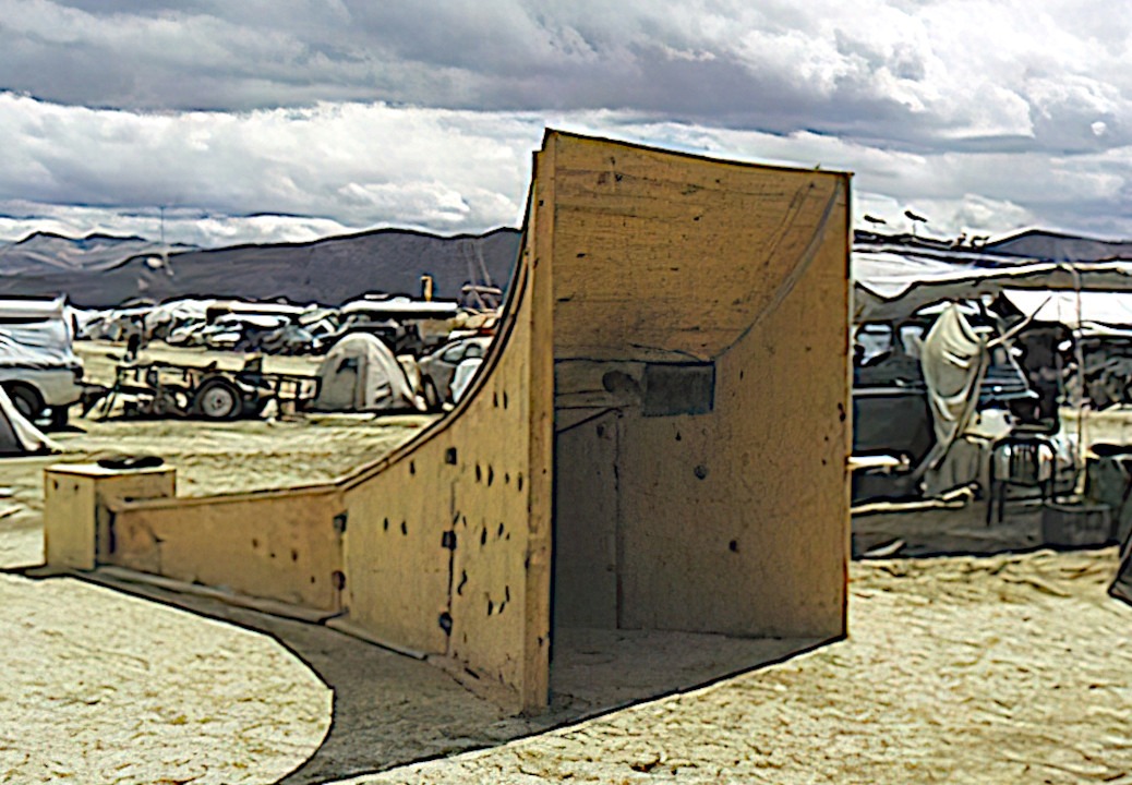

Hoping to achieve 115-120 db clean output with -3 at 20hz, with plenty of headroom to avoid distortion. Being inside the horn, I imagine 110db at 1 watt is not much of an ask. Speaking of which, has anyone taken measurements inside the mouth of a horn?
It really won't be that expensive, as I can do all the work myself and I would be using very cheap alternative building materials. The roof would would be the only part of the whole structure that would be pricey. If taking into account my labor, then yes, costly. The audio/video components would likely cost more than the structure.

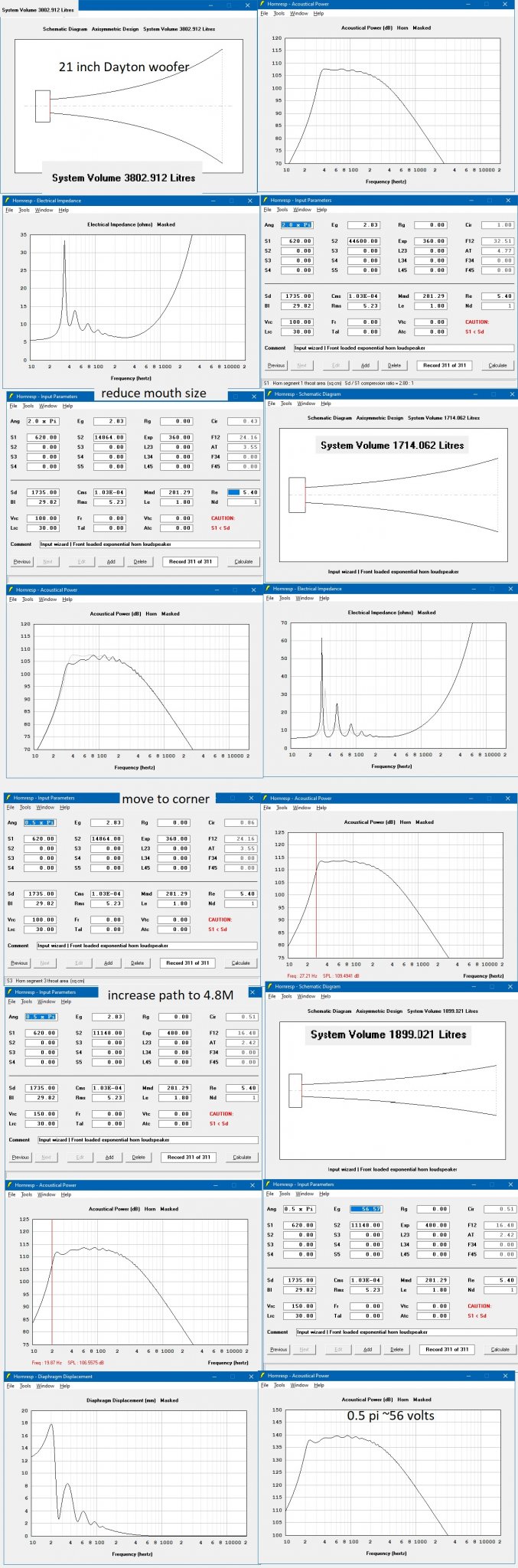

how about one of those cheap Dayton 21" with relatively low Le ?
down at the bottom of the sims is a small mouth and corner loading
a mouth big enough to live in could take some wood - I see horrible pressure treated plywood at $87 a sheet and $67 for common OSB.

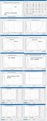

here's a 6th order reflex for that Dayton 21 - 225 liters sans driver and port displacements
a few of these might be decent - there may be more cost effective drivers but
IIRC this one can move some air

In general, but depends on how high up you want it to load and how low the cutoff is; i.e. its upper mass corner as Norman noted. For instance the 14-120 Hz sim I did in the other thread required increasing the driver's Qts' from 0.33 to 0.833 otherwise HR wouldn't calc it.
"You can't get there from here..." Fantasy horns show up here from time to time.... and never get built. Klipschorn is a wonderful room-filling sound and feels like great bass on almost all music, but poops out below 35 Hz.
But just in case, you also need to specify if there's going to be rear sealed chamber and if horn is direct enough to reach as high as mid-frequencies.
