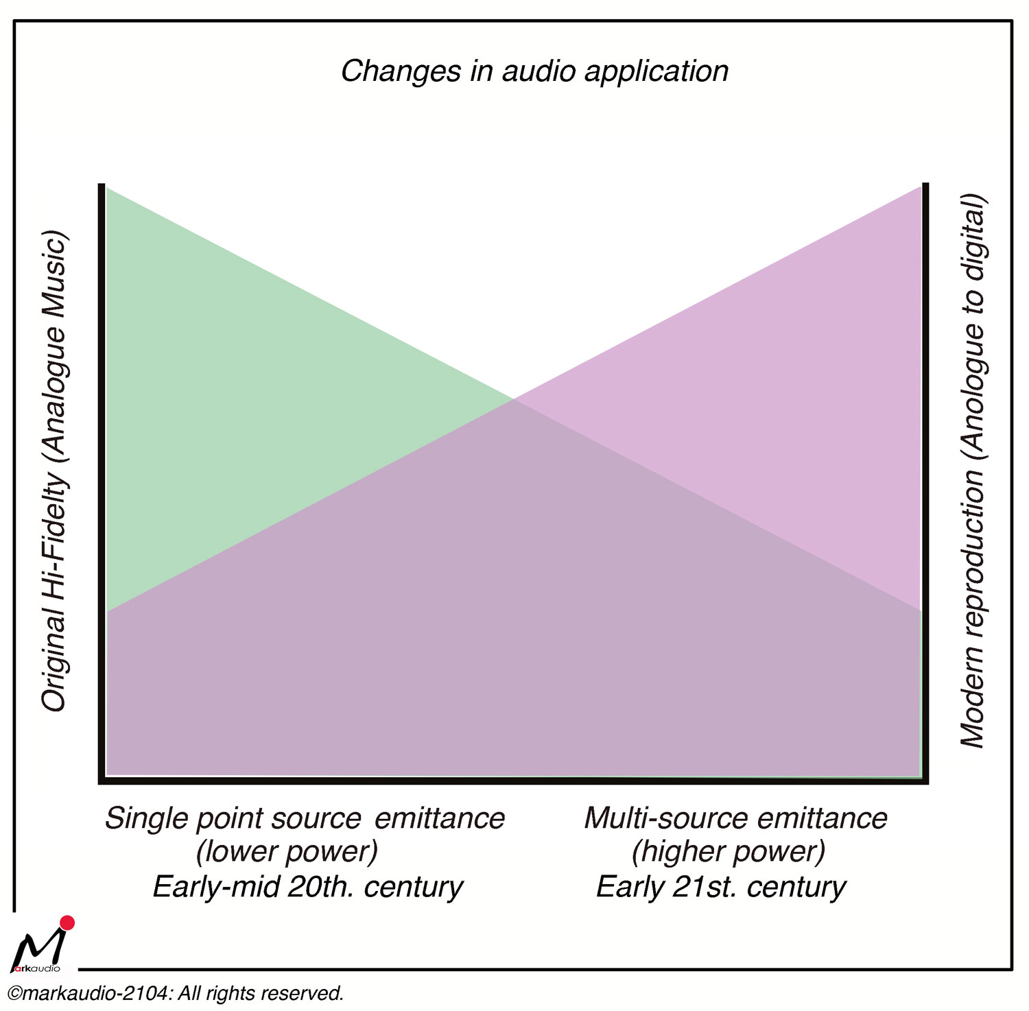

Thanks, Mark. I like the idea of setting up a resource like this, but I'm not sure I have the time and resources needed to do it right. My knowledge of web related tools (e.g. software, web page design, maintenance, and so on) is very limited and my knowledge of the technical side of electronics is perhaps even more so (and I really mean that). As an academic, most of my research efforts are directed towards advancing my own work in the philosophy of nature, the philosophy of technology, and so on, which dominates most of my intellectual life. My interest in DIY speakers and such is simply an extension of my love for music and and my interest in hands-on hobbies (e.g. woodworking, home renovation projects, etc.). I also love the spirit of sharing and cooperation that is expressed on sites like this. I guess my effort to start this thread comes from my many years of experience as a teacher. Having a single, easily identifiable resource that offered multiple perspectives on the topic might be a good help to those developing an interest in this kind of thing, and if their interest grows they will naturally progress to other, more advanced discussions of these and other related issues.
Hi Phil,
Your academic/intellectual approach is most useful and much needed. Like many forums, the majority of contributions posted on Diyaudio.com often comprise of anecdotal opinion, subjective in nature, with little or no authoritative/validated research to afford any reliability to what's being said. A good example of this phenomenon has already arisen in some posts in support of vintage wide-band drivers on the basis that others have criticised their acoustic performance. However, there's no reference to any independent comparative testing between newer and older wide-band designs in these posts. As far as I know, the only recent independent comparative analysis was done in Japan by Ozawa Takahisa San-Japan, a well respected audio tester and author based in Tokyo. He did an analysis of the DIATONE (Mitsubishi) P-610DB, DAITO VOICE DS-16F and the original metal coned Alpair 12, referenced here (reproduction by permission of MJ Magazine Japan, translation by Yasushi Matsumoto San from the original MJ Magazine Japanese publication in early 2010):
http://ansaht.com/uv638jed4/ALP/MJ_3-2010.pdf
Ozawa san's published work indicated performance gains in the newer Alpair 12 driver against the older units in relation to dispersion, power-handling, range output and 2nd./3rd. order distortion. This should come as no surprise as design knowledge, materials and production technologies have advanced over the last few decades. However, we should also acknowledge that evidenced based testing like that published by MJ of Japan can only give some indication of performance gains; For there's little or no serious validated or authoritative research that assesses any connective relationship between the technical performance of acoustic transducers and the cognitive perception of human hearing. One simple anecdotal paradigm is one of mine; I have both a pair of original Alpair 12 units and a mint condition pair of Diatone P-610 drivers. In the past I've derived equal pleasure from both sets of drivers. I've operated them within their particular technical performance specifications; The outcomes being quite different from each other, with little prospect of making a preference other than on personal taste and circumstance.
Anecdotal/subjective opinion might in the future offer a body of evidence available for use in a content analysis, likely best evaluated in one of the "soft sciences" given its non-imperical nature. However, it may be best evaluated against the back-drop of technological development to a propelled symbiotic relationship too/with attitudinal changes in consumptive behaviour. I've attached a chart which gives some indication in changes to a timeline relating to the shift away from single-point-source to multi-way systems; Advances in technology being the originator but demand further adding to the phenomenon. Few of the original full-range transducer designers in the earlier part of the 20th. century could have predicted the progression from original High-Fidelity reproduction (being true to the musical source as possible) to the increasingly digitised audio world where many sources contain sounds that bear less resemblance to any naturally generated output.
As regards the future of Full-Range drivers, my own personal belief is they will play an increasingly important roll in consumer products. That it is possible to extend usable performance from single cone full-range transducer designs, my efforts over these last years are to this affect. The human race is consuming and wasting resources at un-sustainable rates. The development of modern Full-Range drivers capable of extended range with better usable mechanical properties will be a future requirement, since the rate of materials consumption applied to multi-way systems will gradually become non-viable.
Food for thought. Phil - hope this helps you.
Mark.
