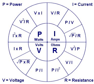

three R's are pretty important , everywhere .....
so - if you print attached image on A4 , you'll grasp it one day .......
I=U/R .......... U=RI .......... R=U/I
1A through 1R will give 1V across resistor terminals
so 0V25 across 1R is 250mA through
use 0R47 source resistors (explained why in 6L6's first post )
if you have enough 1R ones , just double (parallel) additional ones across existing ones on pcb
recheck bias afterwards ...... or - even better - back with bias voltage prior to powering up , then set again

Yes I see where he says it will give more power and assumes mosfets are closely matched. This set came from Tech-diy back when they were supplying parts and I dont know how tightly they are matched. I dont need the extra power, so really dont want to alter them and risk literal "Burning Amp" plus I see 6L6 left in 1R units, I dont need the extra power.......On the other hand, I do have enough 1R resistors to do that.
I will definitely take your advice on powering up. I will make sure first, but I think with my 1R resistors, 1.5 volts is max....not going to try until I am sure!
The amp is biased up to .25 volt, DC offset adjusted to little or nothing. Going to let it cook a little while at this low bias, then measure temps and juice it up a little more.

whatever you do , don't go above 55C on heatsink
though , maybe you don't need more reading , but thinking certainly do - 1V5 across 1R means 1A5 through each vertical par , with 38V rail that means 57VA (57W) which is ..... plenty
luckily , you'll hit 55C at heatsink way before
biasing in Papamps is easy - crank it until you hit any of these :
-35W per mosfet,
-55C at heatsink (taking care of summer T amb. )
-35W per mosfet,
