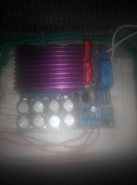

So far what i had in my hands TDA8950 (class D ready build module however) in BTL into 4ohms it will produce about 400Wrms easily ... currently using it for subwoofer duty ...😀😀
Below shows my TDA8950 BTL module ... it will get hot if pushed hard ... need a fan to cool it down ... i think the heatsink is too small from the design 😀😀

that is why TDA8950 class D ic chip was there ... and the good news it can be purchased ready made module ... i had one the power output is really overkill for me ... used for subwoofer duty and at 60% output the subwoofer starts to make everything in the house rattle like crazy 😀😀😀

How many volts are you powering the 8950 with to get 400W average power? Maybe it's compressing a bit which would explain how hot it runs?

Well i powered it using 37V +/- DC ... i assuming it close to 400W into 4ohms due to at 8ohms it is already 300W (on its hand it already killed 2 of my subs😀)

Nice. Nothing wrong with some hot bass. 😛Well i powered it using 37V +/- DC ... i assuming it close to 400W into 4ohms due to at 8ohms it is already 300W (on its hand it already killed 2 of my subs😀)

Another mistake I made was soldering the tda hard up against the pcb.
This caused the front pins to short out on the back pin pcb pads !
So a quick removal of the old tda and soldered in a new one 3mm above the pcb and it worked great.
