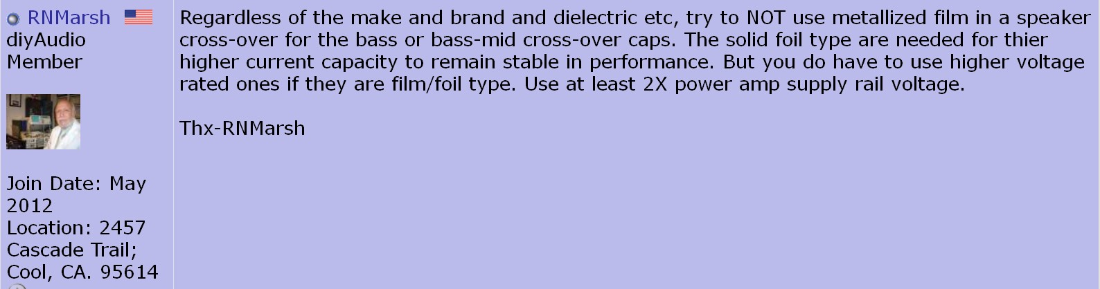

ill be the naysayer. If you have SS Berylium tweeters, they will definitely let you know wht you decide to put in front of them. To what degree do you want to investigate this phenomenon, is up to you. Cornell Dublier sells film caps through major vendors. I believe either 935 or 942c have a 20uF cap for around $20 and is an excellent value. Being sold by major suppliers may save you from being tard and feathered by the dogmatic audio intelligentsia.
The metalized film has distortion and other issues.
Data?
Foils have lower ESR (may or may not be relevant for a given position in a given design), higher ripple current (greater power handling- which, again, may not be a positive if you want the crossover to fail before the driver), but no significant distortion differences.
Don't get hung up about using expensive boutique items like wima.
Mouser shows the 20u PP Wimas from $6-10, depending on which series you want. There's some boutique pricing for ya. If mylar is your thing, you can indeed go cheaper.
I would never use Teflon in a speaker cap unless you want to risk capacitance modulation with signal to provide some extra distortion. Teflon is soft, windings can never be as tight and secure as PP. Great for DC duty, won't cause big issues as coupling caps in amps, but in a high vibration environment where the corner frequency is in the audible range? You can do much better.
