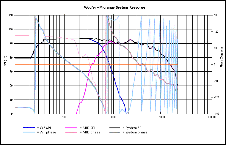

Earl it looks like in your particular application the conditions are such that you make it work just fine. But the generalized case is not the same as your specialized case, I know you know that. In the generalized case there is a distinct difference between phase rotation and the effects of delay. Any novice designer should be aware of this as they apply the principles of the generalized case to their specialized case. Did you look at the plots that I linked to?
I looked into this some years ago, because of exactly the situation that some horns are deep and at higher crossover frequencies the depth distance between the acoustic centers of the CD and woofer (Z axis) could end being one wavelength of the crossover frequency. Of course this means 360 degrees of phase rotation but only at the crossover frequency . Above and below that the effective phase rotation is lesser or more, causing an uneven summation through the entire crossover region, excepting at exactly the crossover frequency.
That needn't be the case, IF the crossover is designed well.
Here's the measured frequency and phase response of my system, comprising a 15" woofer & a CD + horn, with a passive crossover (there's also a super-tweeter for the last 1.5 octaves, but this isn't shown here for clarity).
The Compression Driver's diaphragm is physically located approximately 20cm behind the Woofer's dustcap.
And yet, as you can see, the two phase traces match, not only at the crossover frequency, but over a wide frequency range around it - in fact, everywhere that matters, really (i.e. they only start diverging when either drivers' output is already attenuated below -12dB).
You're crossing at 600hz, which has a wavelength of 56.66cm, while your AC difference is 20cm. Illustrating precisely my distinction between the general and special cases. Move that horn back another 36.66cm and see what happens.
Sure, there are limits to how much AC difference you can compensate for using a passive crossover. And you can always dream up a combination of X-over freq. and AC offset that cannot be made to work.
But, realistically, why would I (or anyone) need to position the CD 56+ cm behind the woofer?
I would think that if you're using a comparatively large - but still realistic - mid horn (as I am), then you'll probably be aiming for a X-over freq. of 600-800Hz, and ~20cm of offset normally work well from a practical standpoint.
If, instead, you're crossing over at, say 1.2kHz, then you'll be using a smaller horn to begin with, typically resulting in a proportionally shorter offset (say, ~10cm, give or take), no?
