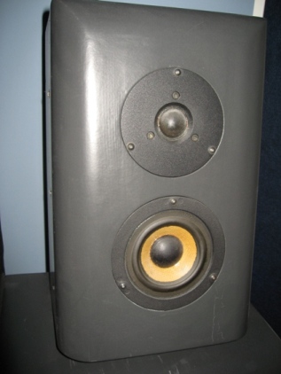

Seems you are applying all the medicine.
Do you have any pictures of these speakers?
The main reasom for starting this thread was because I'm thinking of re-building my mid-high cabinets. These are made of soft-wood (pine) glued together to form a 6 cm front baffle that is highly rounded to minimize diffraction, 5 cm sides and 2,5 cm back .... very solid, but maybe a bit too wide. ...... the speaker sounds a bit too up front, and the sound stage a bit too narrow.
At the moment I dont think the cabinet is actually the main problem (if at all) but rather the fact that they are placed very close to the wall. .... have a new project to fix that by reducing the first refledtion by DIY diffusors 😉
At the moment I'm building a sub cab for a Peerless 12" XLS, and decided to go for a 40 x 40 x40 cm cube of two layer 19 mm MDF ..... it feels pretty solid, and will probably end up good 🙂
