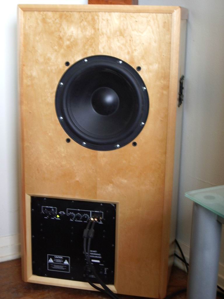

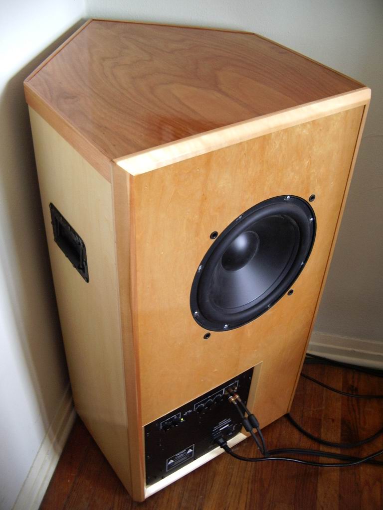

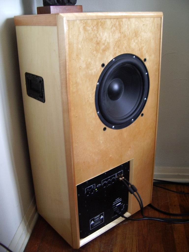

Pics of my 12" sealed sub, which includes panels made of PB and panels made of MDF, all covered with ply. The plate amp is in its own enclosure, isolated from the driver's space. The black things on the sides are the kind of handles used on road gear, and they're a great feature on a box this big. This 6 cu ft enclosure weighs well over 100 pounds, probably over 150.
Note that the back is not a flat panel. I think that might be the single most important factor in determining good acoustic properties of any enclosure. Again, I cannot cite a study or provide hard data, but I'd be willing to learn from anyone who can. I don't mean that speakers with flat backs can't sound good, but all the speakers I've built with a non-flat back seem to sound better. Even with lots of absorbent material, I imagine those soundwaves just banging off a flat panel, straight back through the cone.
