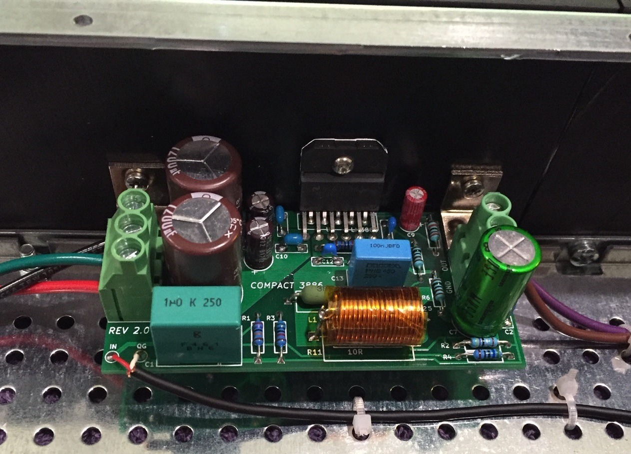

Some of them are relatively small with relatively few components. So the DIY build time is relatively quick and the probability of success is relatively high. Here is one whose PCB measures 45mm x 93mm, as an example.

Thermal tracking, the quiescent current doesn't vary all over the place due to temperature differences between the output transistors and some kind of temperature sensor (for example a VBE multiplier).
Disadvantage: traditionally the PNP transistors are rather poor in cheap bipolar IC processes.
I think the main advantage for DIY is that you can relatively easily make your own amplifier with them.
Monolythic chip means very close matching of all the transistors.
