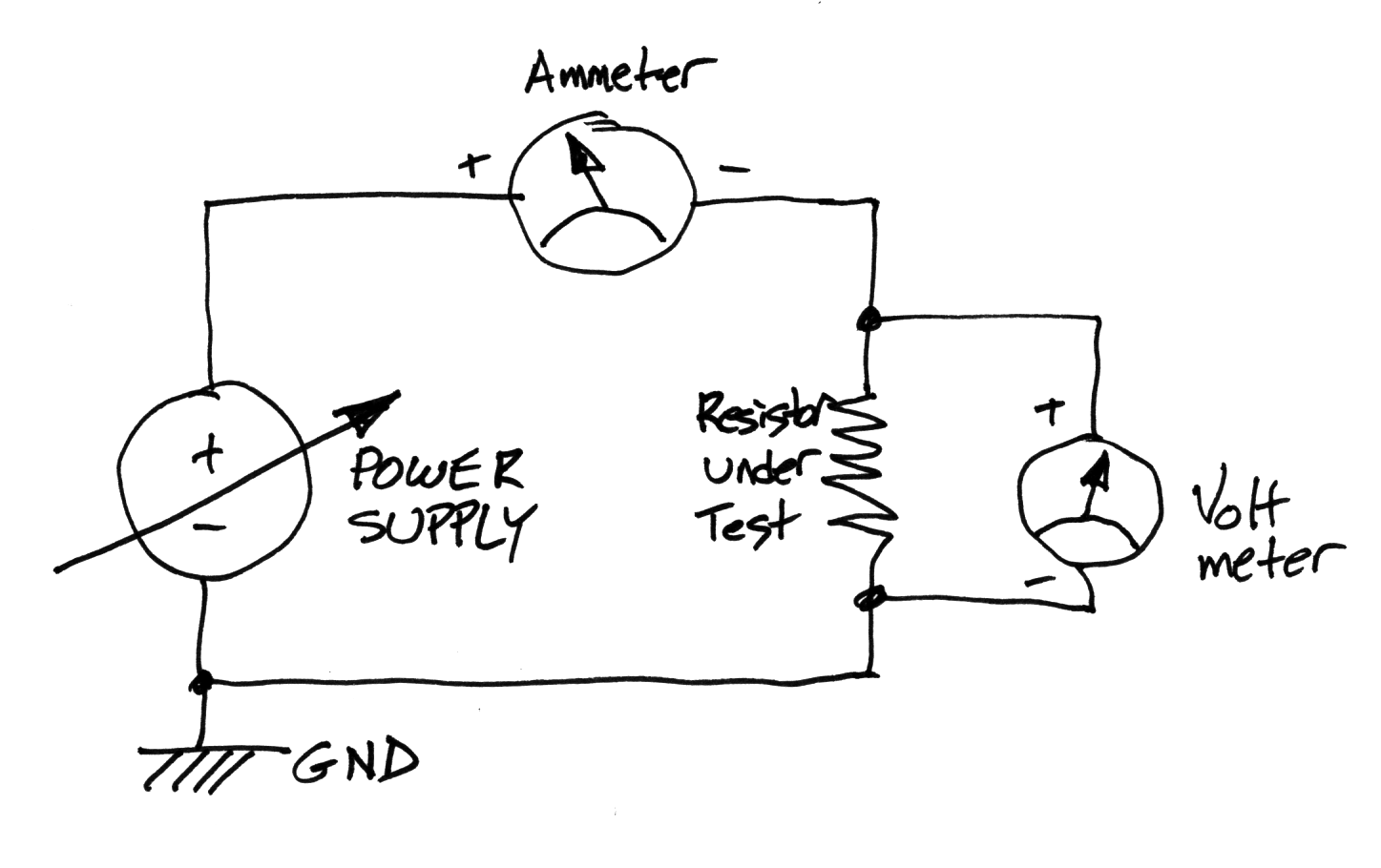

If you are brave and self-reliant and confident you can use two Digital Multi Meters. Configure one of them as an ammeter and connect it in series with the device under test. Configure the other as a voltmeter and connect it directly to the leads of the resistor, as close to the resistor body as possible. Finally, connect this apparatus to a laboratory variable power supply, and slooooooowly dial it up until the ammeter reads exactly ISMART amperes. Then write down the voltmeter reading. Voila you have just measured the resistance of the device under test.
Rmeas = Vreading / ISMART
note: ISMART = SquareRoot( 0.2 * ResistorMaxRatedPower / ExpectedResistance)
I'm sure many readers here can explain how this apparatus uses Ohm's Law to perform the measurement.
