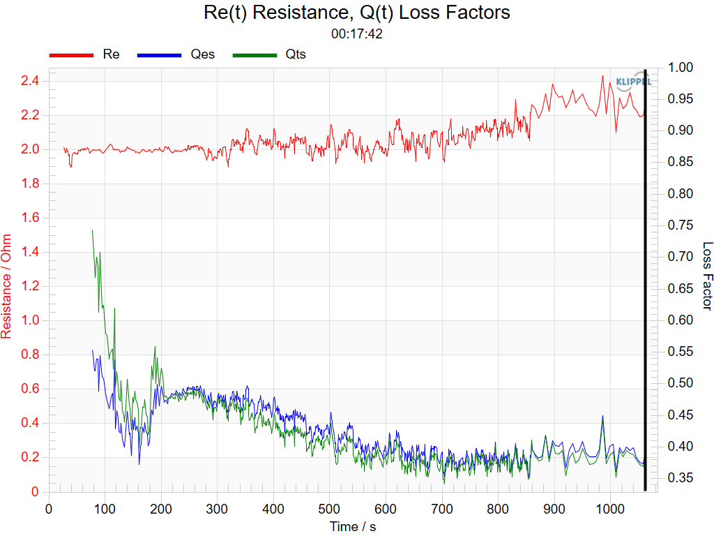

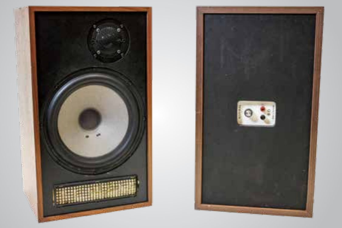

The first product was the Dynaco A-25 (1968), featuring a SEAS 10″ woofer with an innovative rubber surround (rare at the time) and one of the earliest soft dome tweeters — the SEAS H87, a 1.5″ design.
