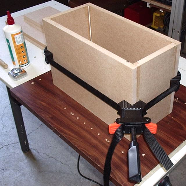

I've used a picture framing clamp for ages and done over 50 sets of speakers with it. If it's a little out just a tap in the right place to correct.
This was used mainly with butt joints but have done a few mitred as well with the assistance of masking tape.
The assembly is only as good as the square cuts and I use a home made saw table. A good quality square is a must and also measure across the diagonal corners. If they are both the same, then it's square. A good flat work surface is also a must.

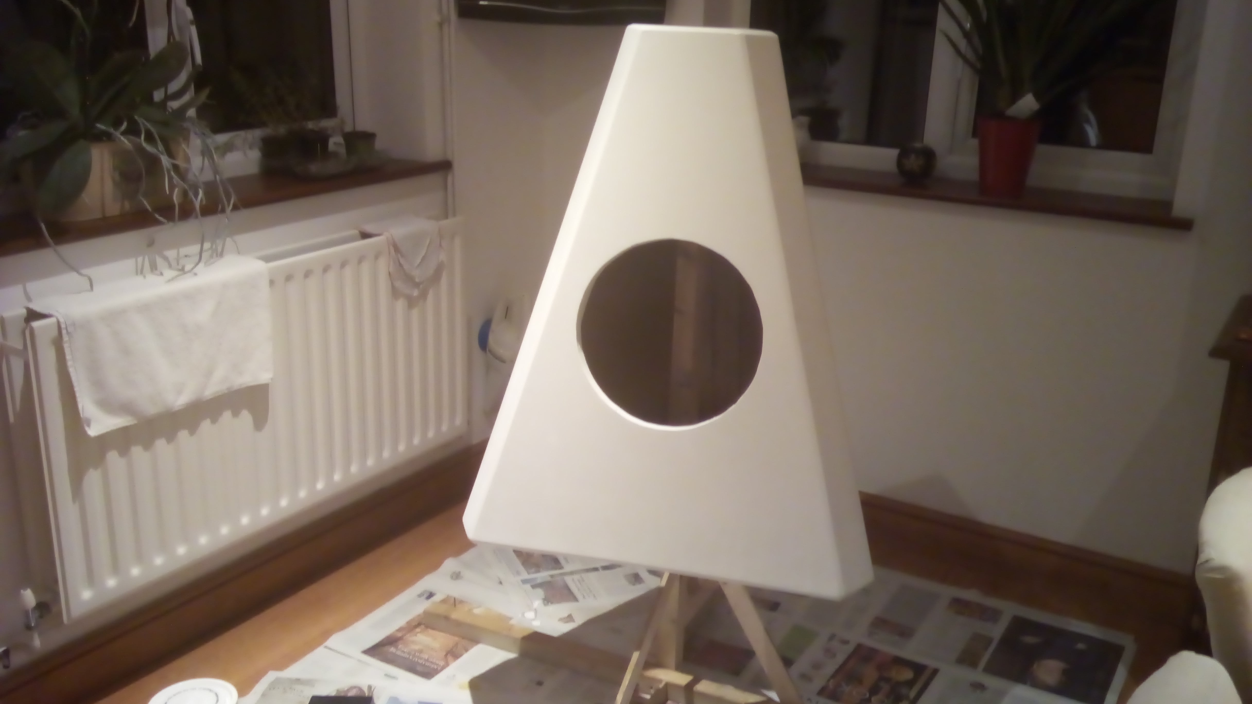

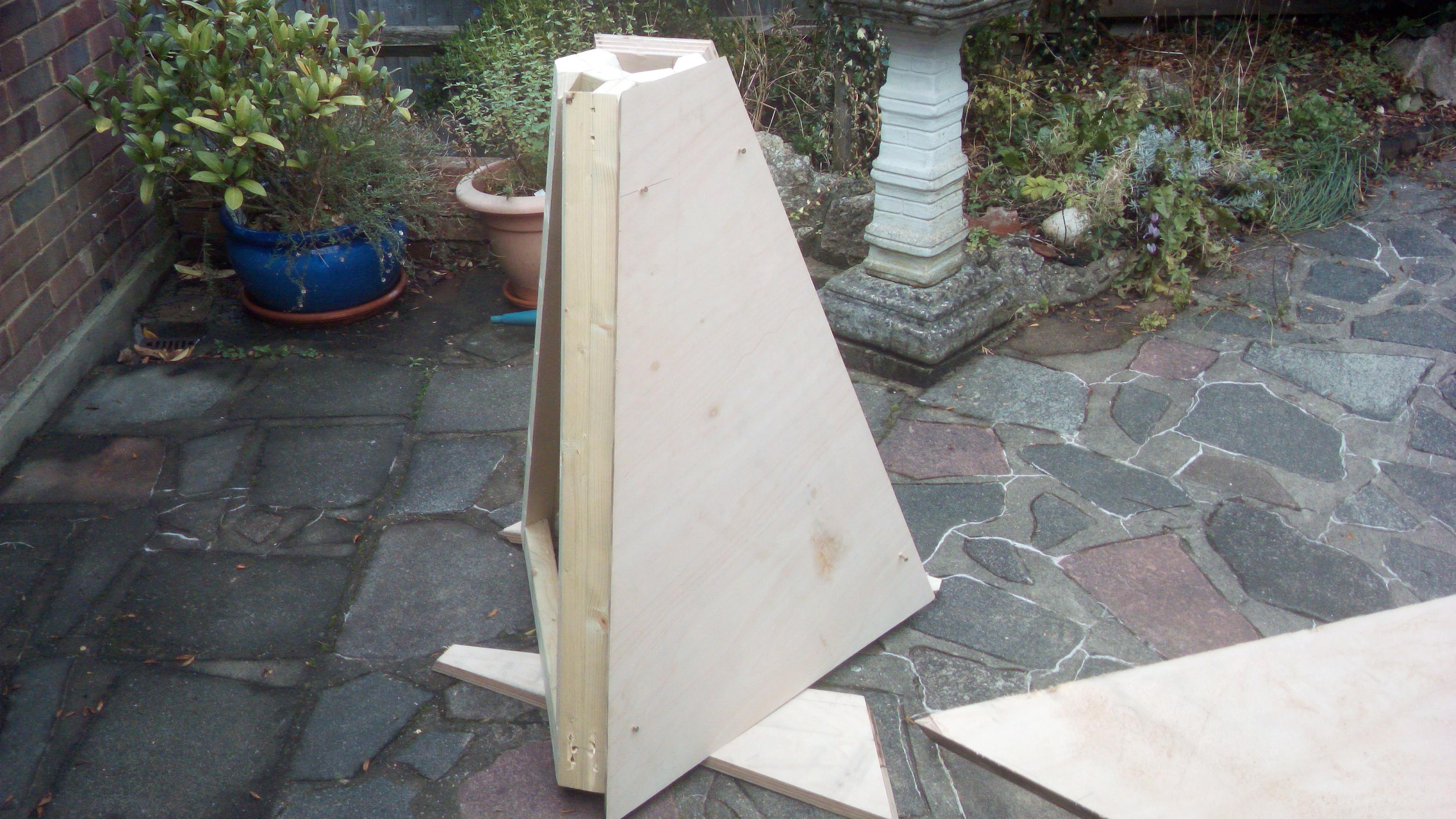

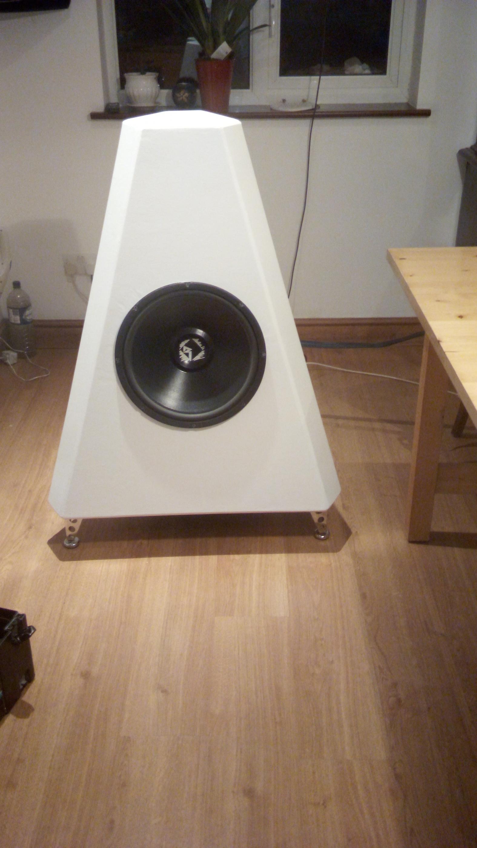

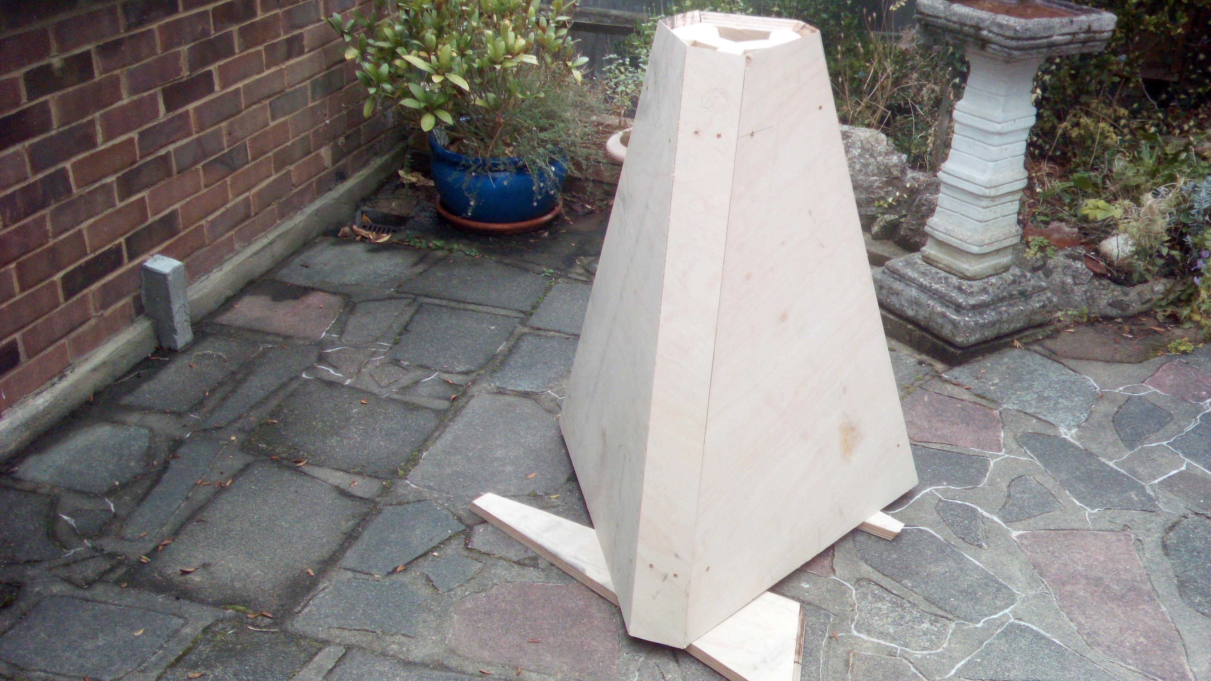

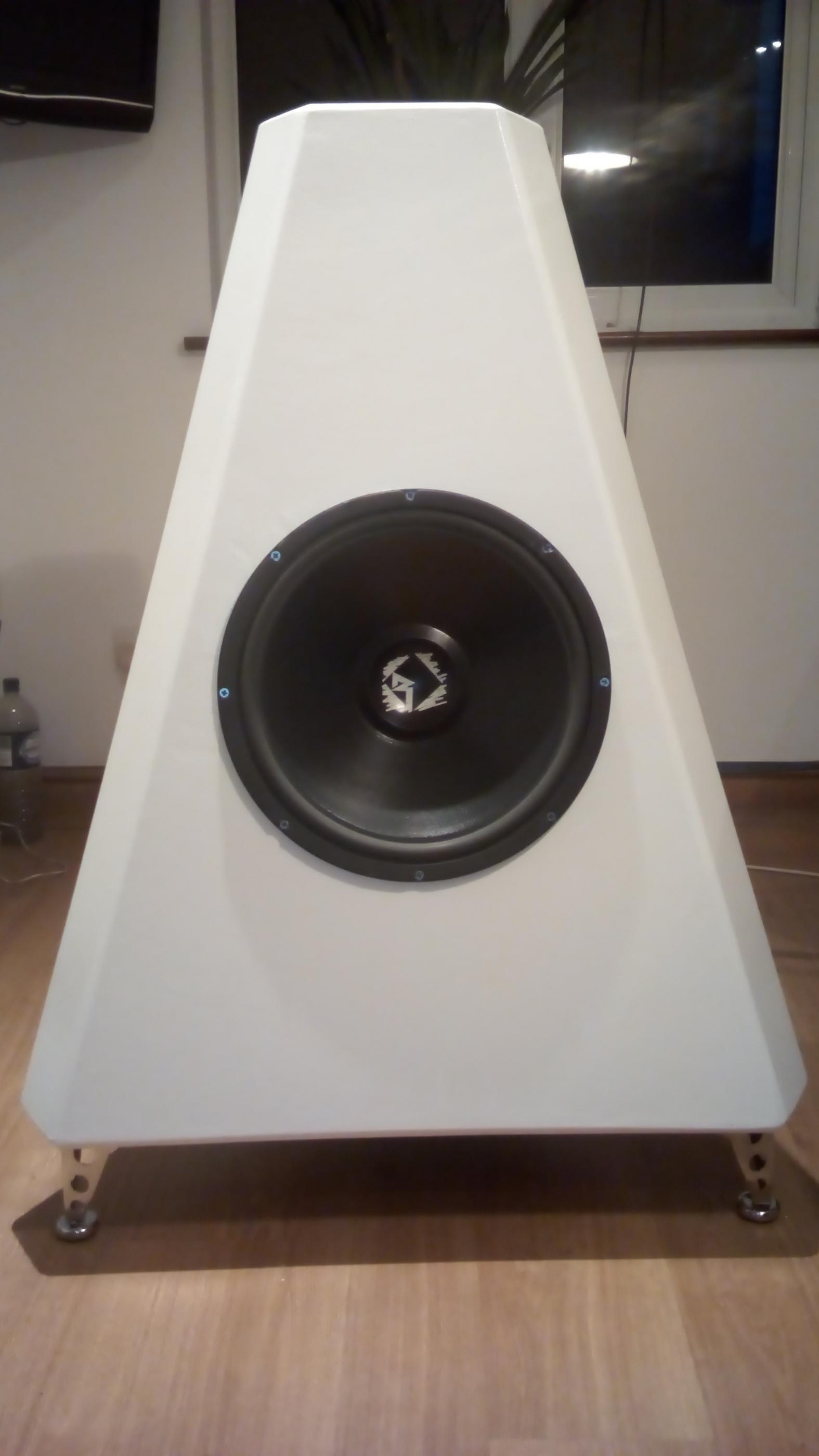

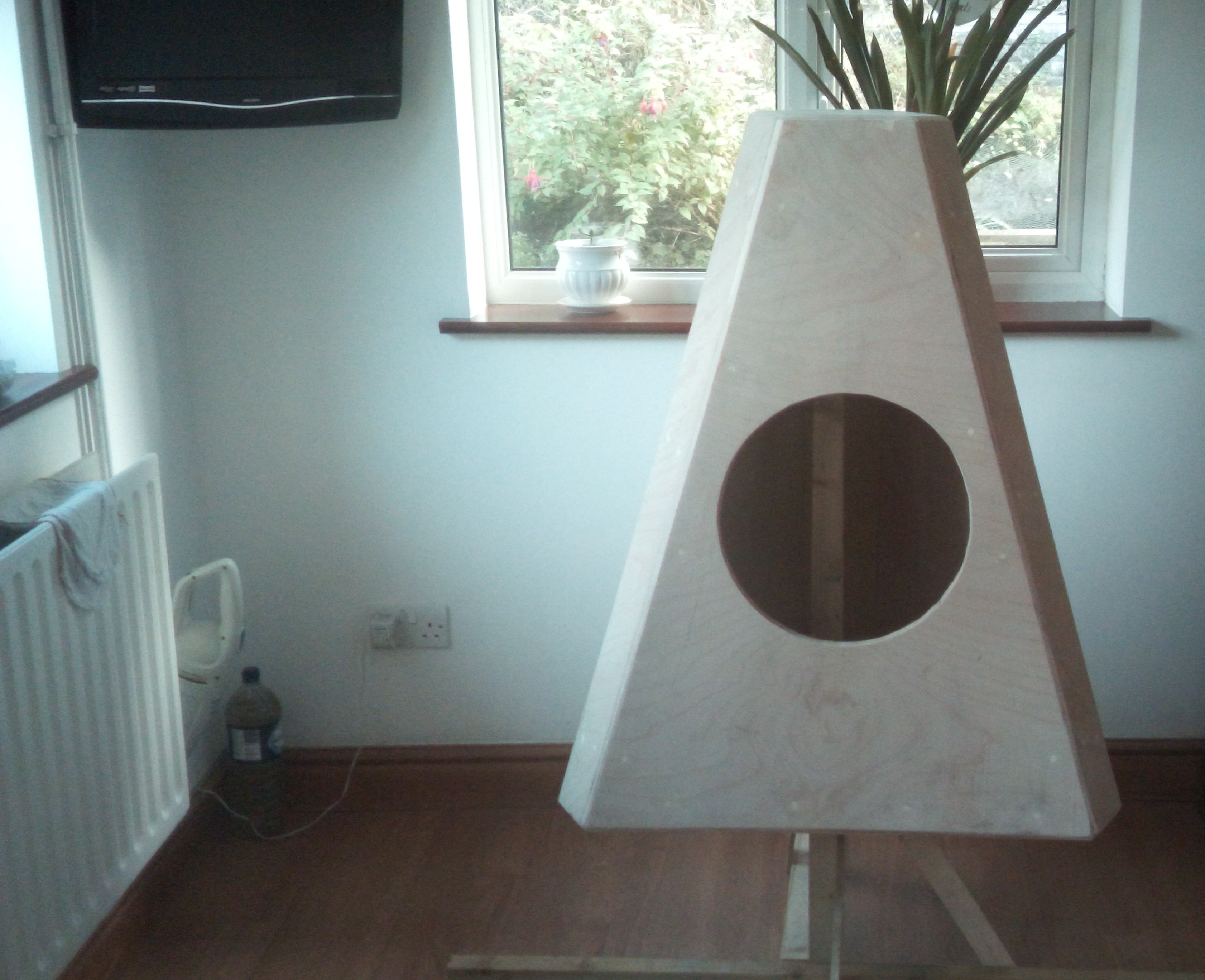

i made this a few months ago. i decided on a "tetrahedron" shape so that it would fit into the corner of my living room, and so that internally no panel was parallel to the waves exiting the back of the speaker. i used 1" structural ply, screwed and glued. it has 2 15" rockford subs wired in series.
