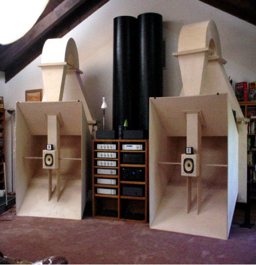

Forget the sealed cabinet with that size speaker, maybe something like that ...😀
PassDiy
