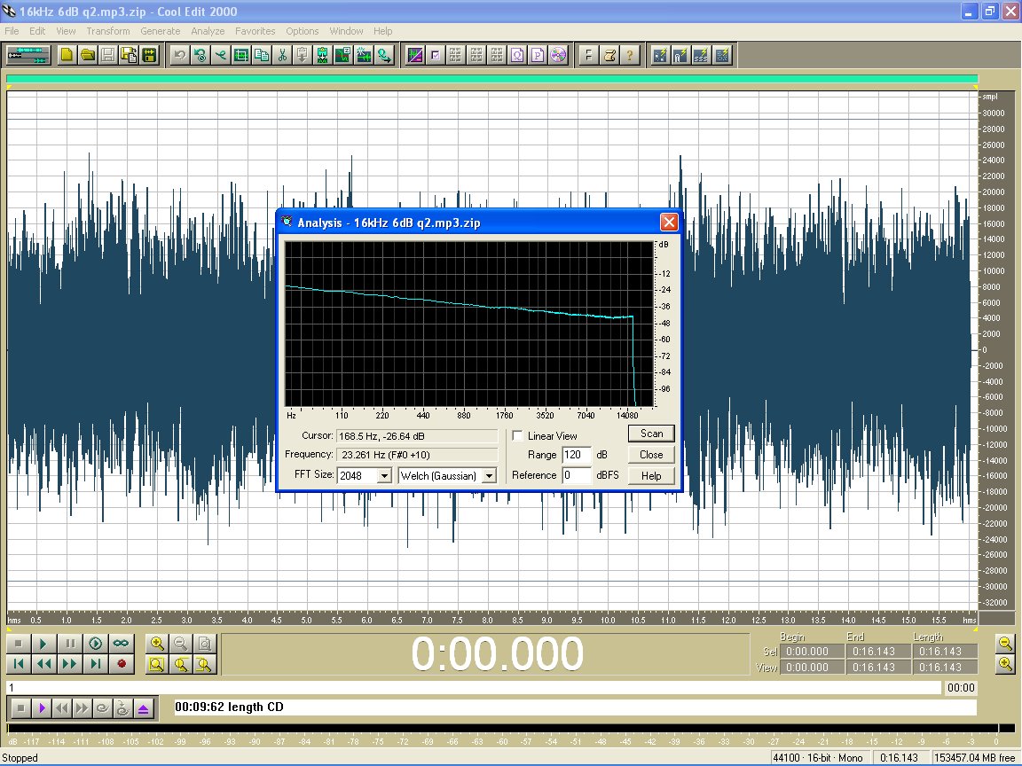

Hello David
Simon has a point. If you watch the file in the analysis window you can see the upper octave being modulated by the filter action but there in no real content in the last octave above 15K. That explains why I could hear a difference at 20K.
Rob🙂
Well spotted, assuming its the MP3 encoding process that has added the brick-wall filter at 15Khz, (probable, but only Dave can confirm this for us by opening the original wav files to compare them) this is a good example of why MP3 can often be audibly different to original source material - I for one can hear the effects of a brick wall filter applied at 15Khz 😉If you watch the file in the analysis window you can see the upper octave being modulated by the filter action but there in no real content in the last octave above 15K.

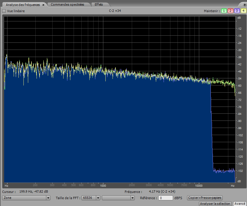

A precision about mp3 encoding. On a pink noise 48000/32 bits floating, encoded in Adobe Audition with it's codec in mp3 48000 Hz. FFT of the diagram max size.
On the diagram are compared the original PCM, a mp3 CBR max bitrate (128 kps in mono) and a mp3 CBR intermediate bitrate (64 kps in mono ).
The two top lines are the PCM and the 128 kps, there is no evident (visual) difference. The zone is the 128 kps where the brick wall low pass appears.

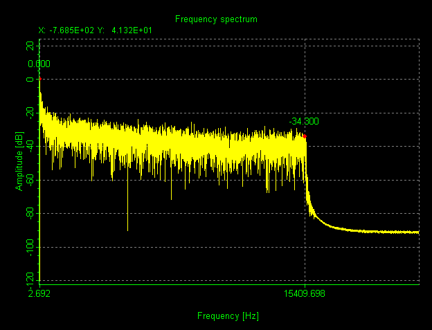

Hey David, thanks for the files. Alas, since you saved them as 64 kbs mp3s, they have a brick wall filter at 15.5KHz. You can see this in the FFT below. Similar to Gazon's graphs above. For what you want to test, that's too low.Here are some samples of pink noise with a response error added.
From my tests just about all MP3 rate brick-wall, the highest at 19Khz. That may be a setting in LAME, the encoder. However, I did find that if you export as Ogg Vorbis at 120 kbs (mono) full bandwidth is retained and the files are small. If you can export that way, give it a try.
Looks like you're right, here's a chart of different low pass frequencies versus quality settings for Lame:From my tests just about all MP3 rate brick-wall, the highest at 19Khz. That may be a setting in LAME, the encoder.
