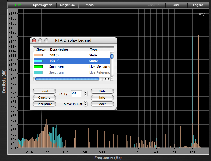

Smaart only reads to 23.74 Hz, so we can’t read the second harmonic above a fundamental frequency of 11.87 kHz.

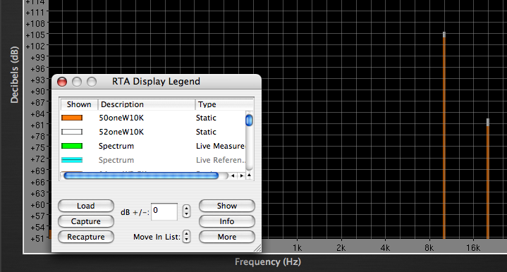

The BMS drivers seem constant in distortion vs. SPL, judging by the distortion at 10 kHz (and other sine wave tests):
4550 four volts (one watt) 10K 104 dB, 20K 80.5 dB -23.5 dB, (<6%distortion)
4552 four volts (one watt) 10K 105.4 dB, 20K 82.5 dB -22.9 dB (around 7.08 % distortion)
The upper harmonic distortion in the 15-20 kHz range should be similar since the SPL generated in the test was almost the same.
The output of the signal generator, amp, DSP, and microphone are quite clean, as can be seen in the twin Smaart screen shots of the BMS 4450 at 16 kHz and the BMS 4552 at 20 kHz in post #180.
I have included a screen shot below with the level raised by 20 dB so the noise floor is visible.
There is some wind noise visible in the noise floor, as well as 60 Hz line noise harmonics, and some driver sub harmonics.
The highest level sub harmonics present in the 4552 with the 20 kHz tone is 57 dB down from the fundamental, THD around 0.2 %.
The loudest sub harmonic of the 4550 with the 16 kHz tone is 60.1 dB down from the fundamental, THD in the 0.1 %. range.

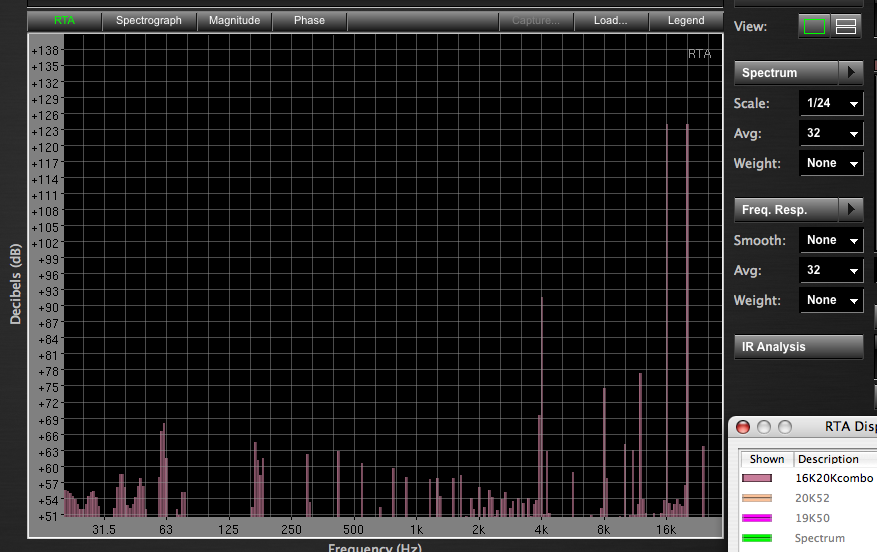

The audio files and RTA screen shots in my posts #179 #182 prove conclusively that the beat frequency of two ultrasonic tones create an audible tone visible on an RTA in addition to the ultrasonic tones, the lower tone generated by the difference between the two ultrasonic tones.
The fact that the ultrasonic tones are causing the audible beat frequency tone is quite obvious in the recording in post #179 when I put my hand between the microphone and the two horns, blocking the 18 and 20 kHz tones, blocking the 18 and 20 kHz tones, which kills the 2 kHz tone the beat frequency caused.
Had the 2 kHz (and 4, 8, 10, & 12 kHz) tone been generated in either of the horns, some portion of the tone would have gone around my hand and reached the microphone.
In post #182 the output of the two individual horns is shown, they are not generating sub harmonics.
The 2 kHz tone is not a “subjective tone” heard only by our ears, it is clearly visible on the RTA graph.
The 18 and 20 kHz tones emanating from the two horns were at a level of 103.9 and 104 dB SPL.
Although our hearing is nonlinear, air is still quite linear at 104 dB.
The audible beat frequency tones generated by the 18 and 20 kHz tones were 71.6 dB at 4000 Hz,
54/6 dB at 8000 Hz, 57.5 dB at 12000 Hz.
A 10000 Hz tone is visible on the RTA at 44.2 dB, in the level range of the electrical and wind noise.
The screen shot below is the B&K 4004 microphone “hearing” the two horns, the level has been raised by 20 dB so the noise floor is visible.
The wind was fairly low for this time of year hear, it is responsible for the noise under 60 Hz, most of the noise at 60 Hz and above are AC line noise harmonics visible in all my tests using the same gear.
Again, perhaps you and others don’t understand the details of my test, I welcome any specific questions.
