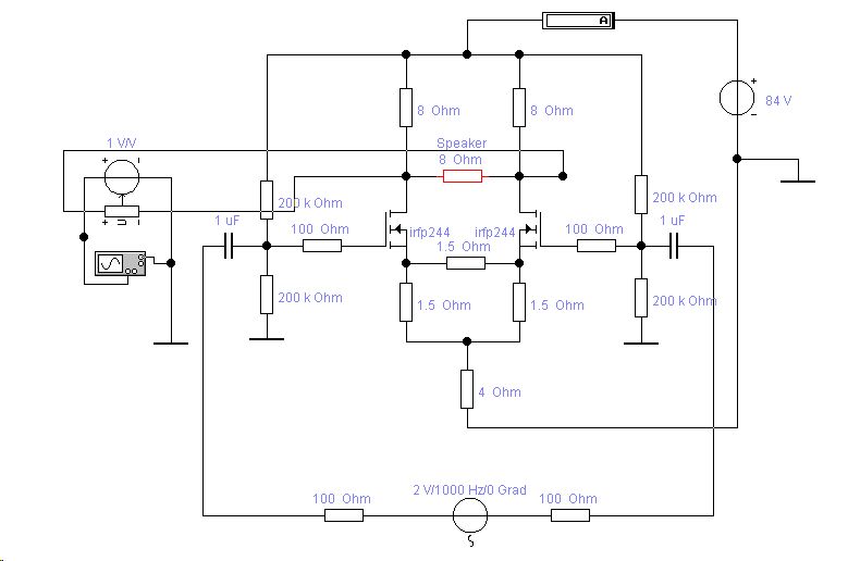

Use asym. supply
you can work with one ac supply of 60v
resulting in ca 82V DC (+ and ground)and use inputcaps for pos and neg input and bias the amp with resistors 200k from gate(of course both sides) to + supply and also 200k to ground. This will bias the amp at ca. supply/2 Volts. You also can try to tweak the values of the resistor. (maybe 180K to + and 140k to ground, just try.)
With your transformer you can paraller both 60-0-60 when you open connection 0(two wires)
then measure the coils and collect both coils
on one side and measure voltage from resting pins
(you have to put ac in!),if 120V then flip one coil at the connection and collect both resting
wires. - so you have one coil only for each channel.
sorry for being complicated.
andreas

Sandro,
I have built a SOZ with a 600VA 25-0-25 toroid transformer per channel, with two 150.000uF capacitors per ch. wich brings the tension to 30V.
I have one heatsink per ch (that I will replace soon) that is PR170 from www.alutronic.de with 375 x 200 x 40 mm with 4kg.
Both heatsinks costed +- €100
The temperature that it has after 30 mins of operation is 100ºC, wich is way to much. (it should be +-50ºC for the transistors and a little more for the resistors).
Before you make a SOZ with that kind of power consider very well the amount of heatsink that is required. see SOZ temperature post for further info.
Pedro

Whoa !!!
60-0-60VAC will end-up unregulated at around 80V for a SOZ.
This will be a gigantic furnace, which you will not be able to lift on your own.
Have a look at the pictures at the bottom of the following page. Note the size and the operating temperature !!!
http://members.ozemail.com.au/~dkfinnis/passlabs/soz.htm
BTW, I don't think 2kVA will be enough at 80VDC rails for a stereo amp....
And ..... I can't lift this one either
mark

Orgonom,
Are you not afraid, that you will inject a lot of hum 100/120hz and amplify that again?
The SOZ is what I would call a current hog. So even the best, read smoothest DC, you can get from a CLC power supply, you are liable to inject some ripple in the gates.
I build something very similar (sorry, I did not do any simulation then and now), and had this problem.
However, you can think of different solutions for this problem.
regards
