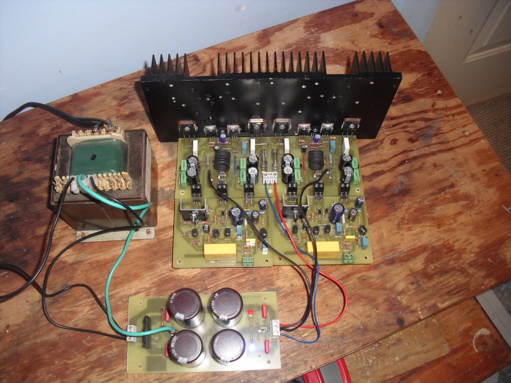

Quasi's amp is good , but it is more of a "blaster" (power with no refinement) No beta enhancement ... a working amp , but no refinement. No to-3 here , all to-247/to3p (plastic). The BX of mine is so simple, my daughter put one together in a hour. I does have 8 transistors for the input stage/ current source , but can work between 0C and 60C, 35V to 80V rails and still have under 1mv offset and killer sound. The "poor man's" amp (below) I just finalized can outclass any typical HT receiver for sound AND "kick" and costs under $60USD (2 BX's ,1 PB60X2, and the PS50 power supply). Loud as hell on a 15" 3-way loudspeaker system , puts out about 80+W/8R X2 with NJW21193/4 or the 2sc3263/2sa1294 sankens that are in the prototype.
If you ever want to "explore" just swap out a voltage stage , hear a "leach" or a "symasym" , "blameless" .. etc. 😎
The whole deal below fits in a shoebox with room to spare..
