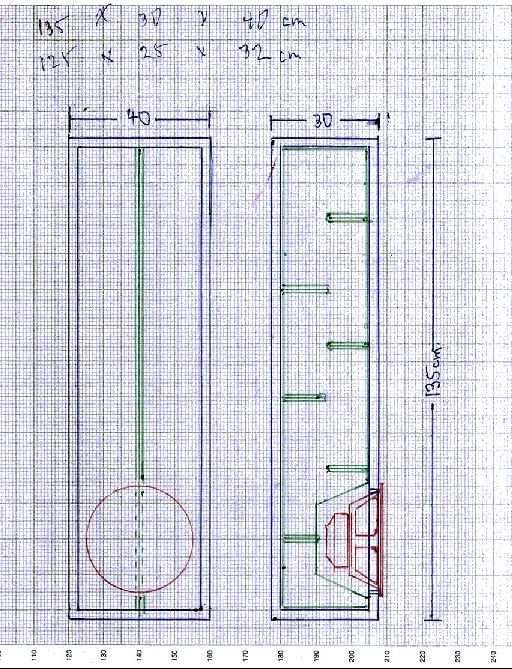

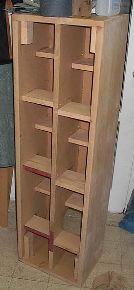

here goes
the box is as in the drawing attached, meassures are in centimeters, stuffed loosely with synthetic fibers, something called acrylan over here. the wire inside is simple copper 2.5mm section multicore wire.
the back is currently just screwed not glued, for adjustments
the crossover is a low level passive XM46 marchand unit . the two low frequency signal channels in the XO are bridged with two 10K resistors for a mono output.
i just don't have room for two woofers. since bass is weaker the the high signal, i put a 50K potentiometer at the high output for tonal balance.
as for mid and highs, it's two BG RD50 ribbons, set as monopoles, driven by a WAD kat6550 amp.
the source is marantz cd5000 as transport and 'deltec enlightment' DAC connected straight to the XO

Well, I see several areas worthy of investigation.
1. You don't really have a closed box. You have a closed end line with insufficient stuffing. That's going to cause response irregularities in the frequency range where "wooly" might be applicable. And, with the back just screwed on, it looks like it might be very leaky.
2. You are crossing to close to the natural roll-off of the ribbon. That's destroying the LR slopes you thought you had.
3. I'd want to look at the effect of summing the LP outputs of the crossover as you are doing. Marchand does say 10K minimum load but I'd bet a boatload of bananas the curve isn't ideal.
4. The box size you are using is to small. That woofer calls for a larger box for a more reasonable Q.
I'd start with a 160L box and if you need those dimension ratios, I'd mount the woofer in the center.

the box is "supposed" to be sealed. in the drawing is how the back is attached to the side. i added an extra frame around the rear side in the inside of the side walls after i took the above photo.
the roll off of the ribbons and woofer box volume are within the recommended, and the responses of the XO are nice LR slopes
but then again, if it does not sound good, all those things are worth rechecking
other things to be concidered are leakage from around the driver, the LP frequency. a bad driver unit?
