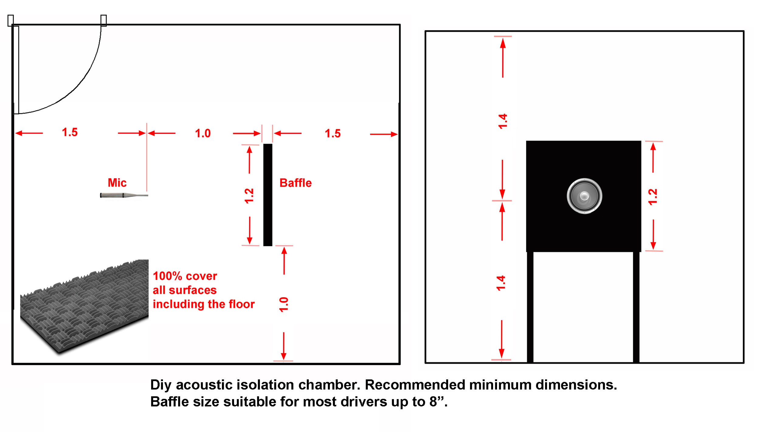

2 - This is a more practical and useful question. For those guys who want to do full-range frequency testing at home (note the words "Full-Range"). Here's my advice: (Tux, note the positions, dimensions and foam isolation requirements):
A - Invest is a decent mic. Don't buy the cheapo mics that cost below US$300. They are fine for general set-up but Not for accurate testing below 50Hz and past 15-kHz. Take a look at the Earthworks measurement series, at the very least, their M23 but this is only good up to 20-kHz. Expect to pay around US$500 for a M23. You'll need the M30 or the M50 is you really want to find out more:
Measurement Series | Earthworks Audio
B - Try to get hold of hardware/software like Linear X V4, DAAS, MLSSA and similar test gear. There's also something available for Mac that Dave (Planet 10 uses - Dave please mention as I can't remember the name).
C - Beg, borrow (or steal) your wife's, granny's, friend's spare room, basement etc. and set about creating an isolation chamber within: see my sketch pic attached (dimensions = Metres).
Regarding the acoustic foam on the floor, you'l need to carefully cut large rectangles, treating them as mats to be lifted and put down during the measurement process. For siting the mic and driver, buy a small laser pen and place in the same clamp as the mic. Aim it directly at the centre of the driver's dust cap. Once aligned, carefully exchange it for the mic. Just 10-mm off alignment will create measurement error so take lots of practice to get it right.
Could be a great collective project for a group of audio buddies. Remember, this is an isolation chamber, unlikely to become anechoic, but at least its a reasonable opportunity to remove the worst of the external variables.

Ah ha! The answer to one of my questions.You use a 1.5m square baffle with the driver centered. I know you know, but neophytes might not -- The shape of the roll-off below 200-300Hz is almost entirely dependent on the baffle. Some manufactures will put a sealed box behind the baffle and that totally changes the shape of the response curve.
Bob
Bob
Bob
Hi Bob,
Actually, we use large volume sealed box with interchangeable front mounts. Best I take some pics when time permits. I'm flat out busy at the moment.
Given that I'm suggesting a simple DIY isolation arrangement as possible, a large sealed test box needs +1 metre clearance around it, so will increase the size of the isolation chamber.
