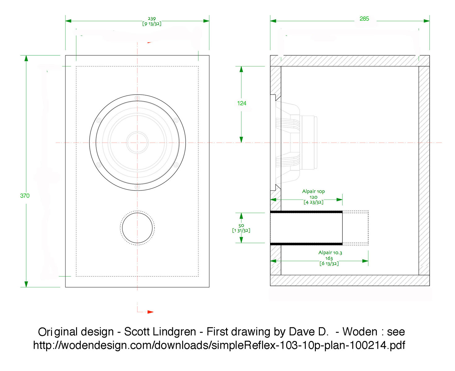

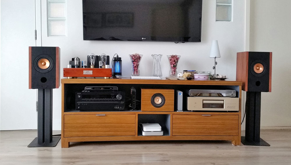

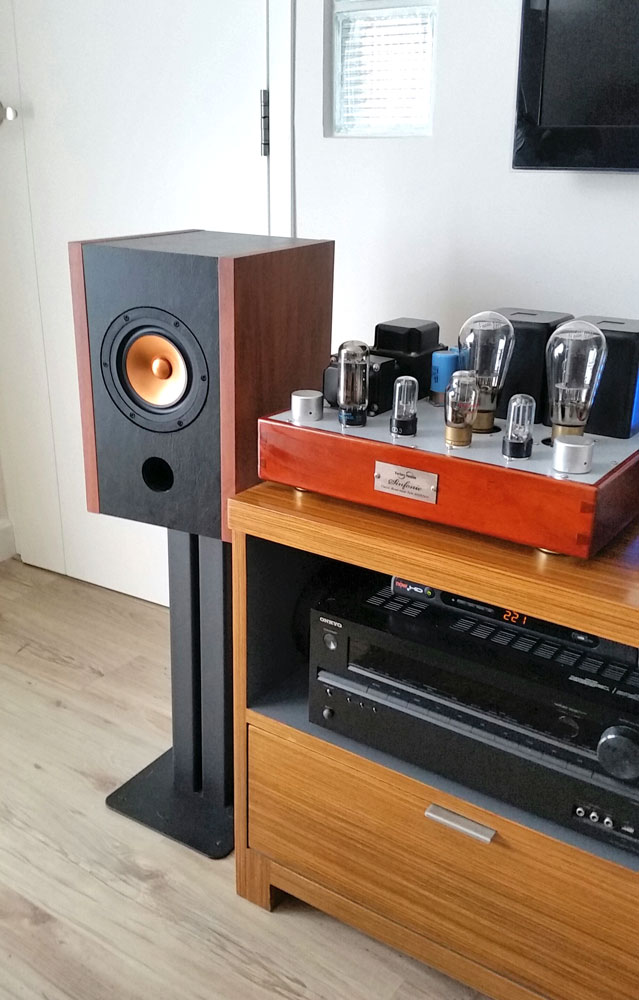

I've been getting excellent results with a slightly modified BR box design originally from Dr. Scott. Its height (O/D) has been shortened from 403mm to 370mm. I'm currently using a 300B SET, Accuphase DP65 CD player, Mac Mini - ITunes for sources (see pics).
Excellent large (if slightly soft) bass from the port @ 160mm, quite wide LF responses considering its a port. I'm finding the smaller internal volume suits my tastes from the original larger box, but bear in mind this is personal listening preference.
Scott also mentioned to me that a 12litre box using a 35mm port around 110mm long could produce a pleasing alignment. Good thing about simple BR's is they're easy to make and affordable. I'll make a few more during the months ahead.
I'll be using my 6V6 next week to compare.

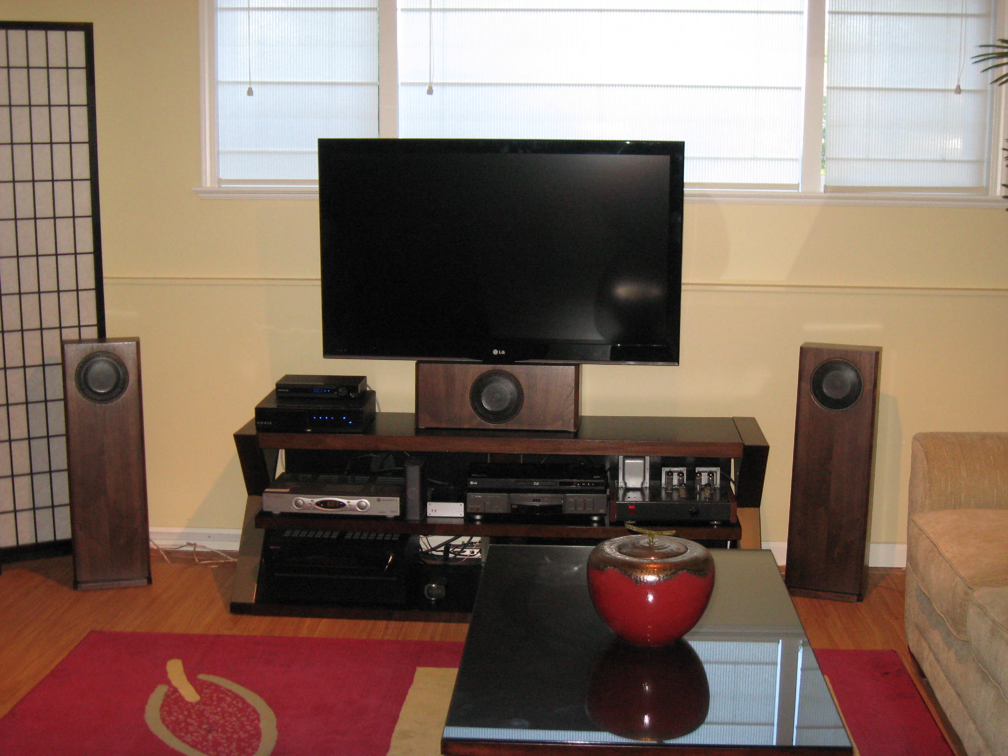

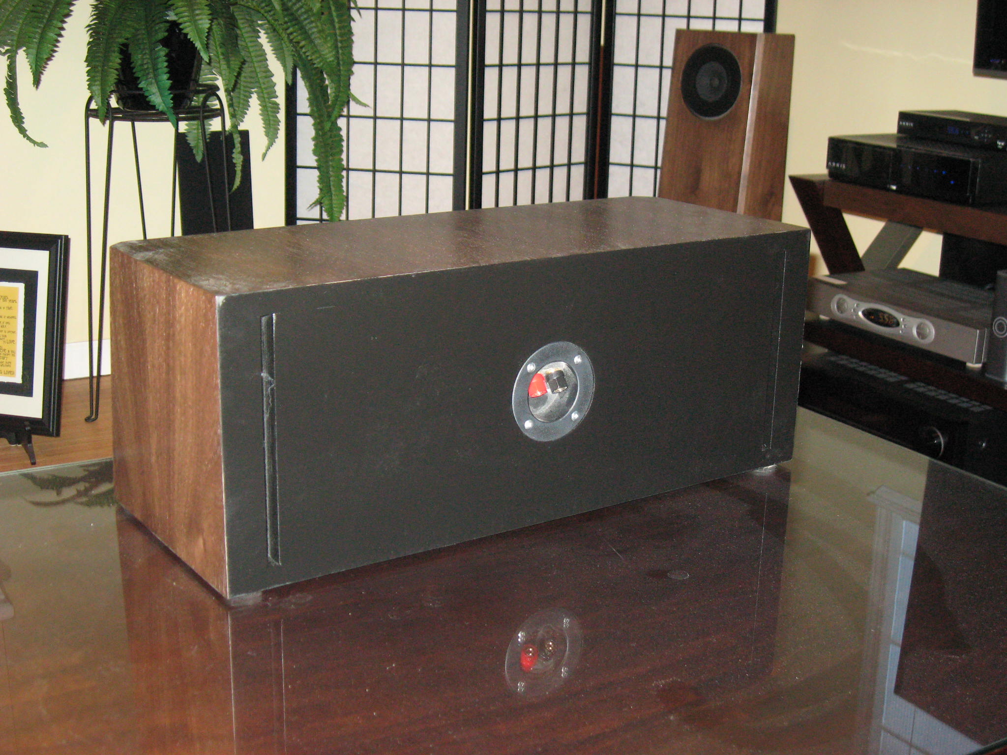

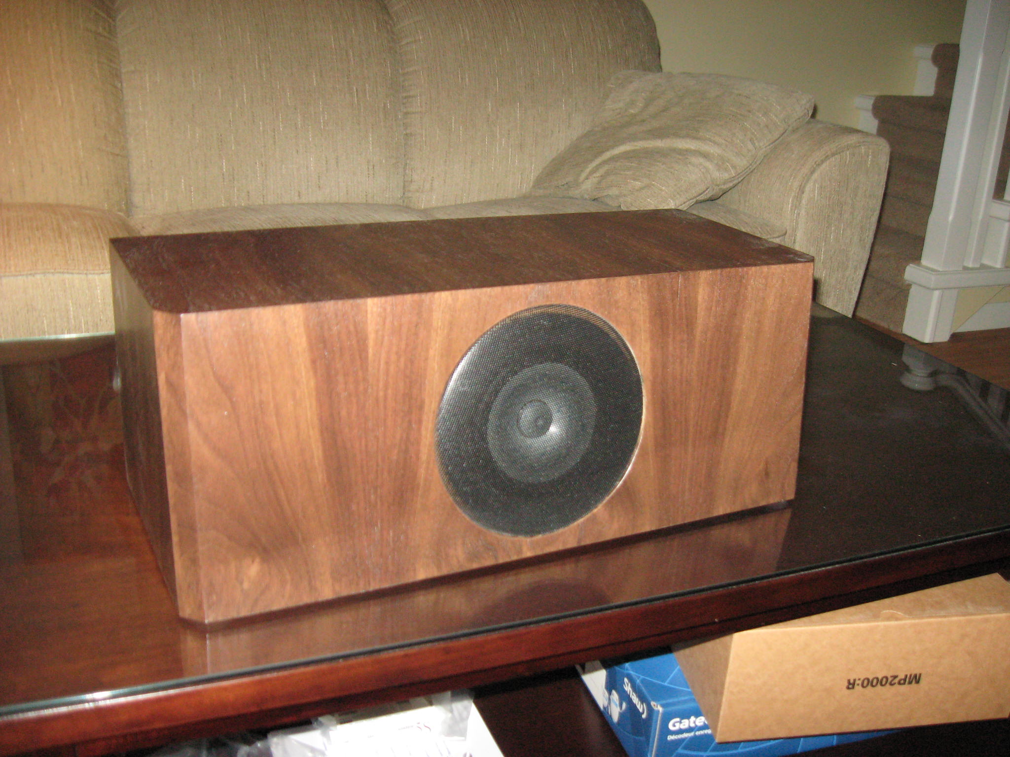

I believe between Dave @ planet10 and other DIYers posted projects, there are plans for center channels for all generations of Alpair10s - I built one for the 10P a short while ago, along with a short floorstander.
Shiny dark finishes and dust - sometimes makes for unflattering photos 😡
And since this thread is about amps used, in this system it's an Onkyo TX NR 818 - a pretty decent rig
