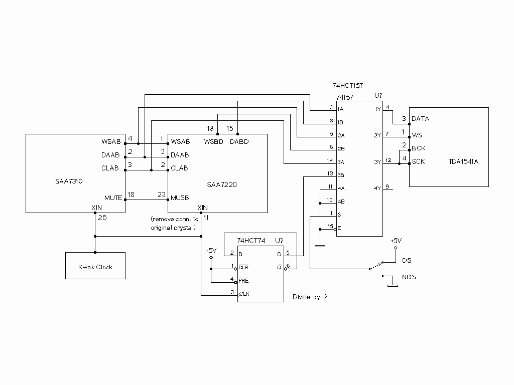

The SAA7220 do really need to be reclock to sound ok, some even slave the receiver and reclock the digital filter and the dac withe same xtal clock to get better sound, like in the schematic I post here, the SAA7310 can be raplace by a better receiver but I think it need to use a 11.2896 mhz clock. I would like to use a WM8804 but this one need a 12mhz clock in hardware mode.
What do you think of this schematic ?
Its not doing reclocking because the '157 is a mux, not a latch. You wanted reclocking? Also in NOS mode, I'd want the SAA7220 not drawing its 180mA typical supply current 😉

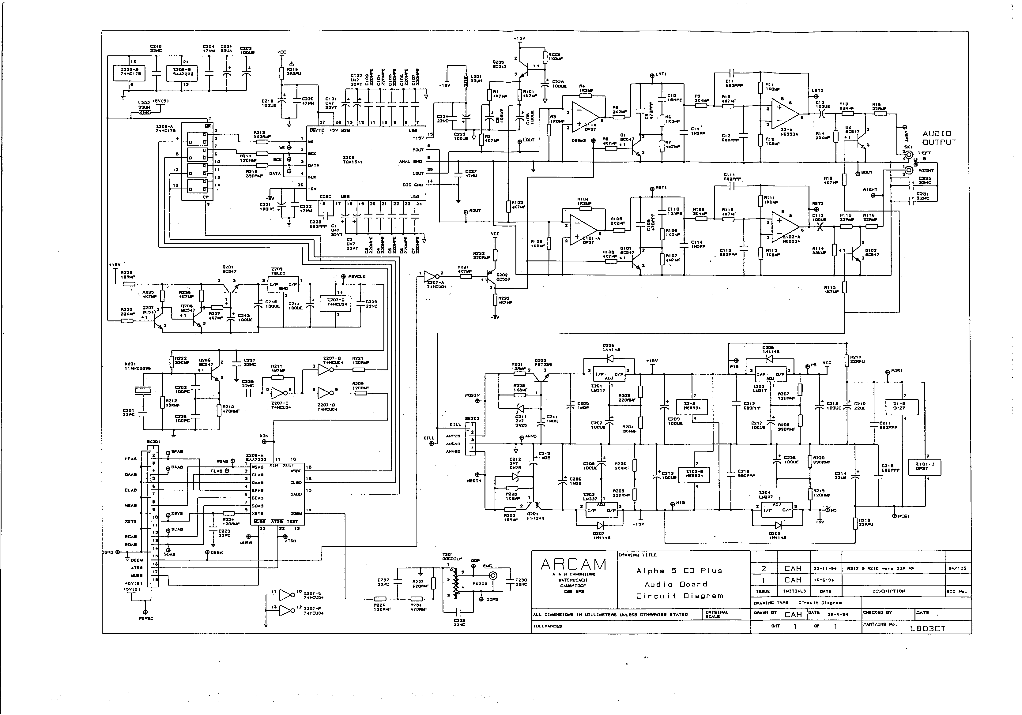

Yeah - they do a nice reclock but then blow it totally by using OP27 in the I/V stage. I can't think of a worse choice at the price 😱
