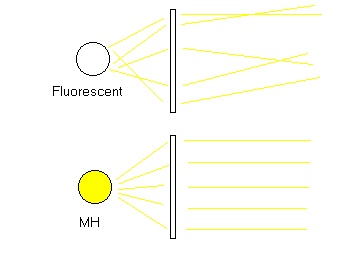

In general fluorescents are not good for projecting because they give a 100% diffuse light: Light can travel in any random direction from any point on the bulb. This makes them pretty much impossible to direct into a strong beam, which is what we need for projection.
The bulbs being used here (MH, HQ, Halogen etc...) emminate light from any point on the arc outward in the shape of a sphere...You can more or less draw theoretical straight lines of light path pointing out like a sphere from the lightsource. With a fluorescent you have to draw straight lines from the lightsource willy-nilly in all directions.... If you put a, for instance MH, point light at the focal point of a fresnel, the fresnel can turn that light into a straight beam very effectively.
The difference between a diffuse light source and the kind used here can be thought of as combed hair vs messy hair.
I looked at the Kino-Flo website though and noticed that they have a fixture "Para-Beam" which tries to direct light but i don't think it turns it into enough of a beam.
Well you would have to make the fixture yourself like I suggested. IT would be about 6-8 15" lights next to each other. This would make a "pannel" light to use. I figgured that the fresnel wouldn't have a problem dealing with that. IF the fresnal wasn't able to make a beam could you use 2 fresnals (one just above the lights) and the original one to make a beam?
The problem is something like this:
(Diffuse light just ends up coming out diffuse on the other side of the fresnel, while "directed" light ends up coming out of the fresnel directed --- same thing with reflector...Diffuse light hitting it will come out diffuse, while directed light hitting it will come out nice and directed)
