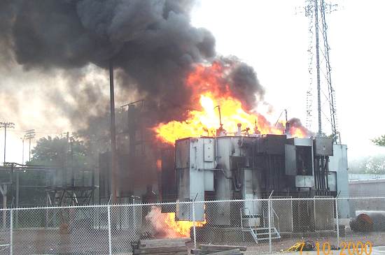

im not looking for a 3 watt amp, i need it to power 300w speakers, and i thought it'd be nice to build my own tube. but thanks for reading!
Charles Darwin knew finches, not tubes
You don't have to receive the Darwin Award posthumously.
