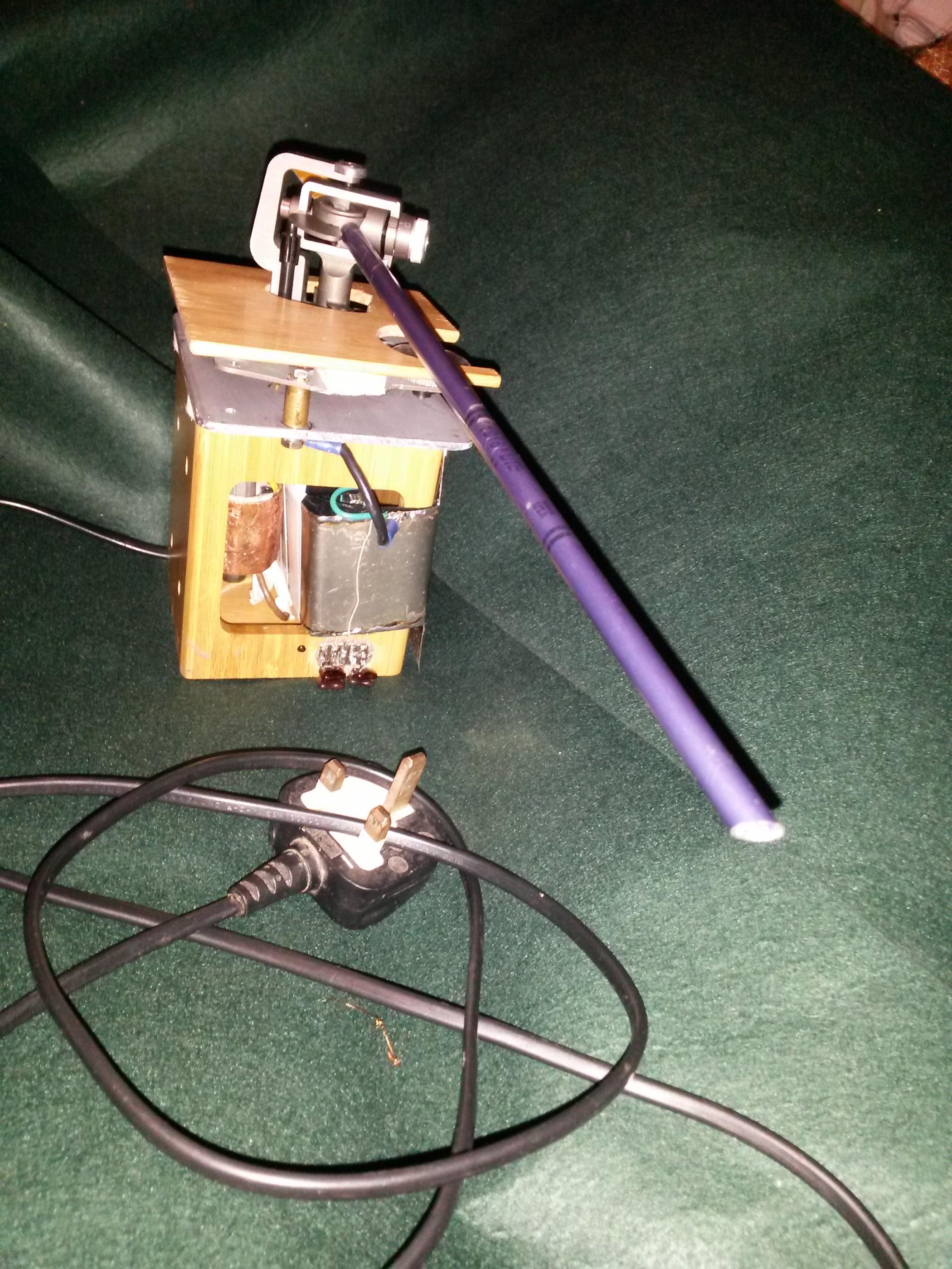

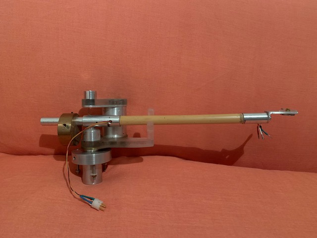

Three ways to help reduce vibration in long arms -
Use cheep alloy ( I think this was previously a tent pole.
Drill holes in it, I coped the pattern from a modified Rega arm.
Machine it to ( three, in this case ) diameters, I guess you could do something similar with a drill and emery paper if you didn't have access to a lathe.
"Archery arrow shafts... Range of mass and stiffness and anti vibe coatings LD"

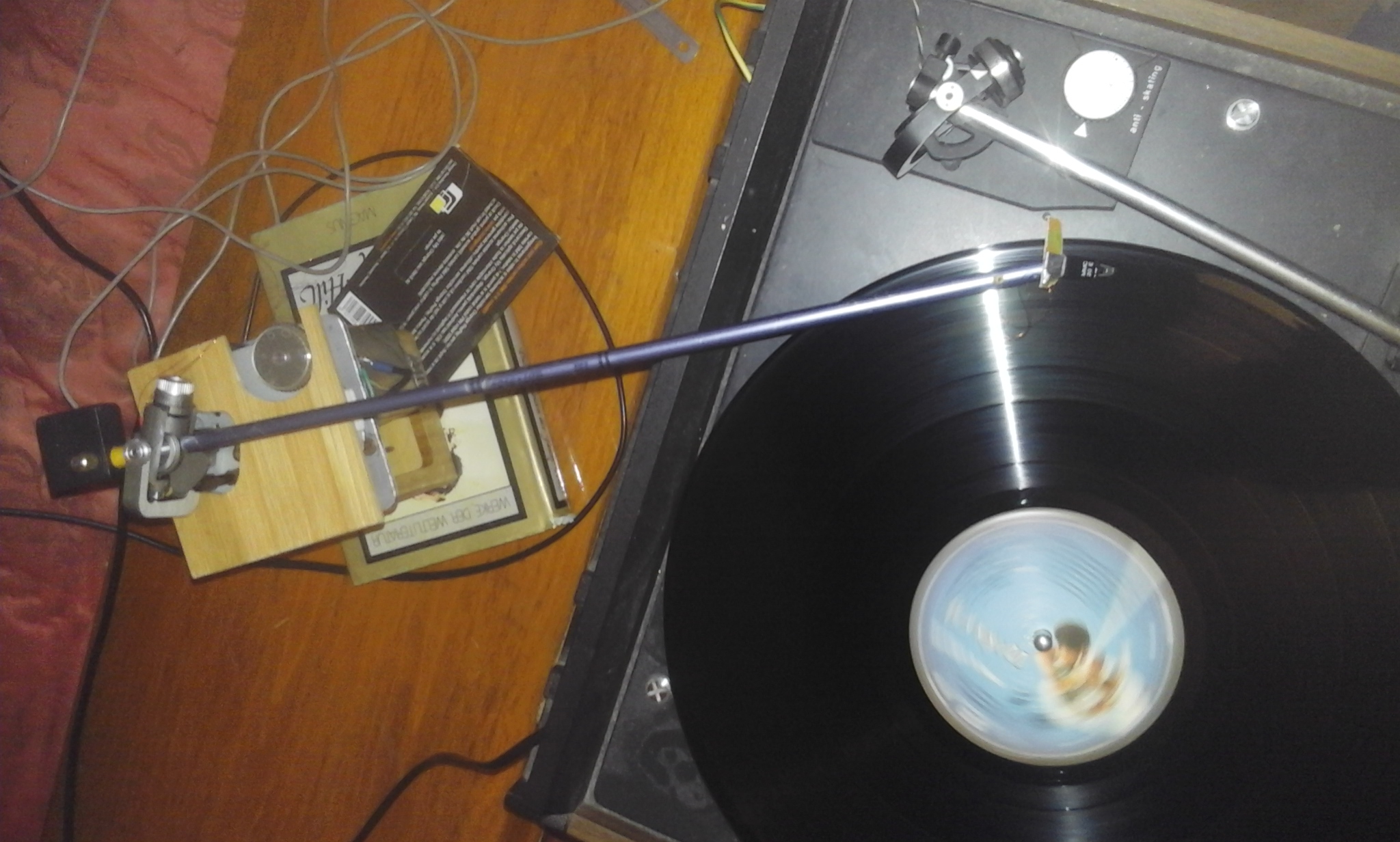

It's what i used first, actually one of the best and it prooved to be a terrible idea...Its alloy is brittle and trying to drill big holes in it can cause it to split or break, then it became a singing object by itself, a true resonating box .Maybe laser cutting would work better in that avionics 0.3mm thick wall alloy tube .Flat pcb tonearm is 100 times less prone to vibrations while 2...5 times less heavier than usual tonearms and you only need a good pair of scissors to cut it.Unfortunately the cart mass is 10 times higer than the tonearm's so the longer the tonearm, the higher contribution of cartridge, no matter the weight of the tonearm itself.
Hi, dreamyh
If you have access to a lathe, the Easton 2712 aluminum arrow shaft can make an excellent tonearm tube. This is the max legal diameter arrow shaft for competition matches. The OD is aprox .440" with .012 wall thickness. To damp any resonances I made from magnesium 2 hourglass shaped "washers" that were about .4" long. Picture 2 .177 cal. flat nose pellets glued face to face. These washers were made a snug fit for the ID of the shaft. I drilled a 3mm hole through both and used thin wall teflon tubing to go all the the tube, for the wires to fit through. I then used powdered cork to fill the space between washers for dampening. You can put these washers at any arbitrary place in the tube. This procedure sounds harder then it actually is, but it works.
Good luck.
Joe

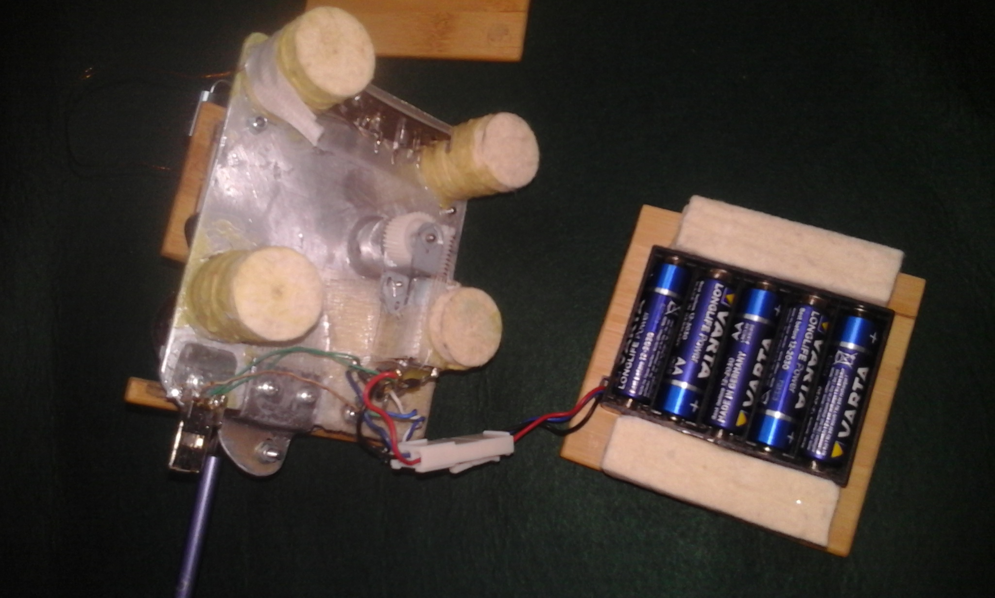

I think i made smth a bit similar in principle around 2017...2018, a tangential tonearm floating on water made of two carbon fiber cones one into another fixed with polyurethanic foam tape working on a floating structure on watter.I coppied the idea from an old gentleman that seem to have died or just dissapeared along with its youtube video and blog.Unfortunately i don't know any conical arrow made out of that alloy.A friend of mine uggested to use some polyurethanie spacers to keep the wires in the middle of the alloy tube just to get rid of the interaction between the wires and tube but there was more to it and i just needed some very light tonearm so i changed to flat tonearms idea and i'm not ready to look back because i consider now Jiri Janda flabby flat tonearms far superior to tube ones.
Yup all interesting stuff. Tonearm tube is basically a windchime and how natural resonances are managed is the crux be it holes coatings internal damping etc etc. Physics of it says the outer coating is the place to have a damping layer, ie a material which is lossly when it flexes and only has to be thin. LD
