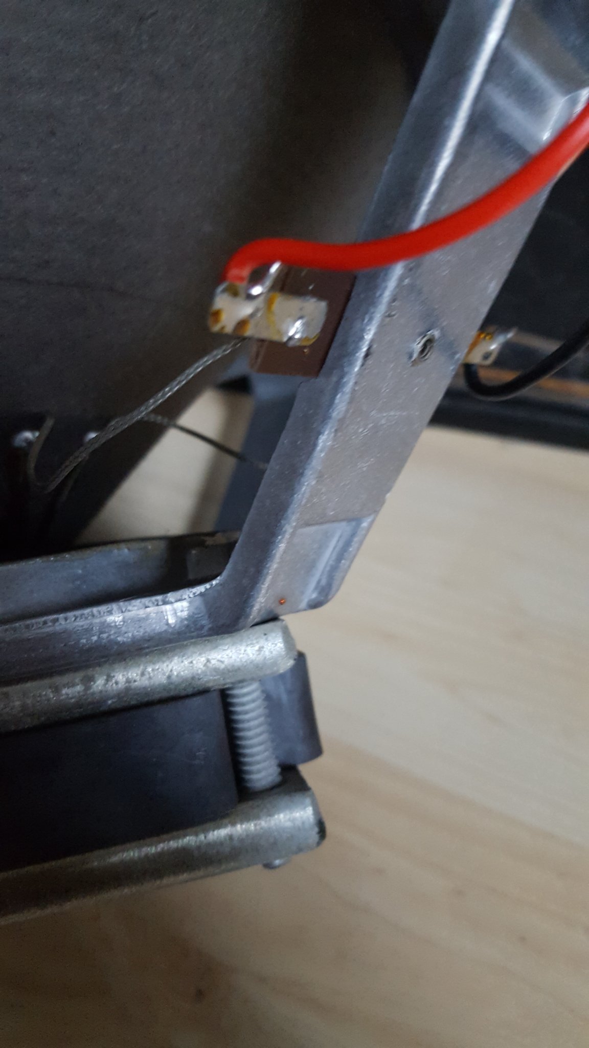

Hello folks, I hope I'm in the right place. I have a pair of Wharfdale speakers (vintage) Dovedale 3. The bass speaker 102.15 model 3014 6ohms dc in one of the cabs cuts out . If I give it a tap or gentle push , it kicks back in. Can anyone advise ?

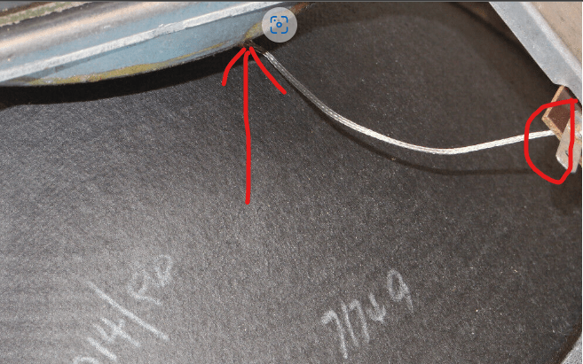

If you are gently pushing the cone and it cuts back in then it sounds like an intermittent connection either within the voice coil (bad news) or maybe where the coil connects to the 'tails' (not great news but might be fixable) or a bad connection where the terminals are wired to the crossover. The tails are where the thin voice coil wire connects to the flexible tail of wire that goes to the terminals.
You need to have good look first and check any obvious connections for good connection.
If it looks like this then the arrowed part is where it gets tricky as that is where the thin voice coil wires connects to the tails. You need to be sure that is where the issue is before even thinking about whether its fixable. All other connections are easy to get at.
See what you find first.

Hello Molly, thanks for getting back to me. Electrics really isn t my bag, but I've taken the speaker out and all the wires seem to be connected and clean.
An intermittent fault does not always give a visible indication.
Try wiggling the woofer connecting wires and the flexible tails around while music is playing to see what action causes the cut out of sound.
Hmmm. Based on what you say about pushing (I assume you mean on the cone) then that really does point to a break somewhere. The point where the tails connect to the coil is the point that can see flexing in use as the cone moves. If these have been used with vinyl (and so lots of rumble that moves the cone a lot but quite slowly) then that can be a cause.
All you can do initially is connect the speaker to the amp and gently move the tails with a biro or similar and see firstly if you can recreate the problem and get it to cut out. See what you have to touch, prod and poke to get it to cut out.
This is what rumble does. You can't hear it but there is lots of flexing:
