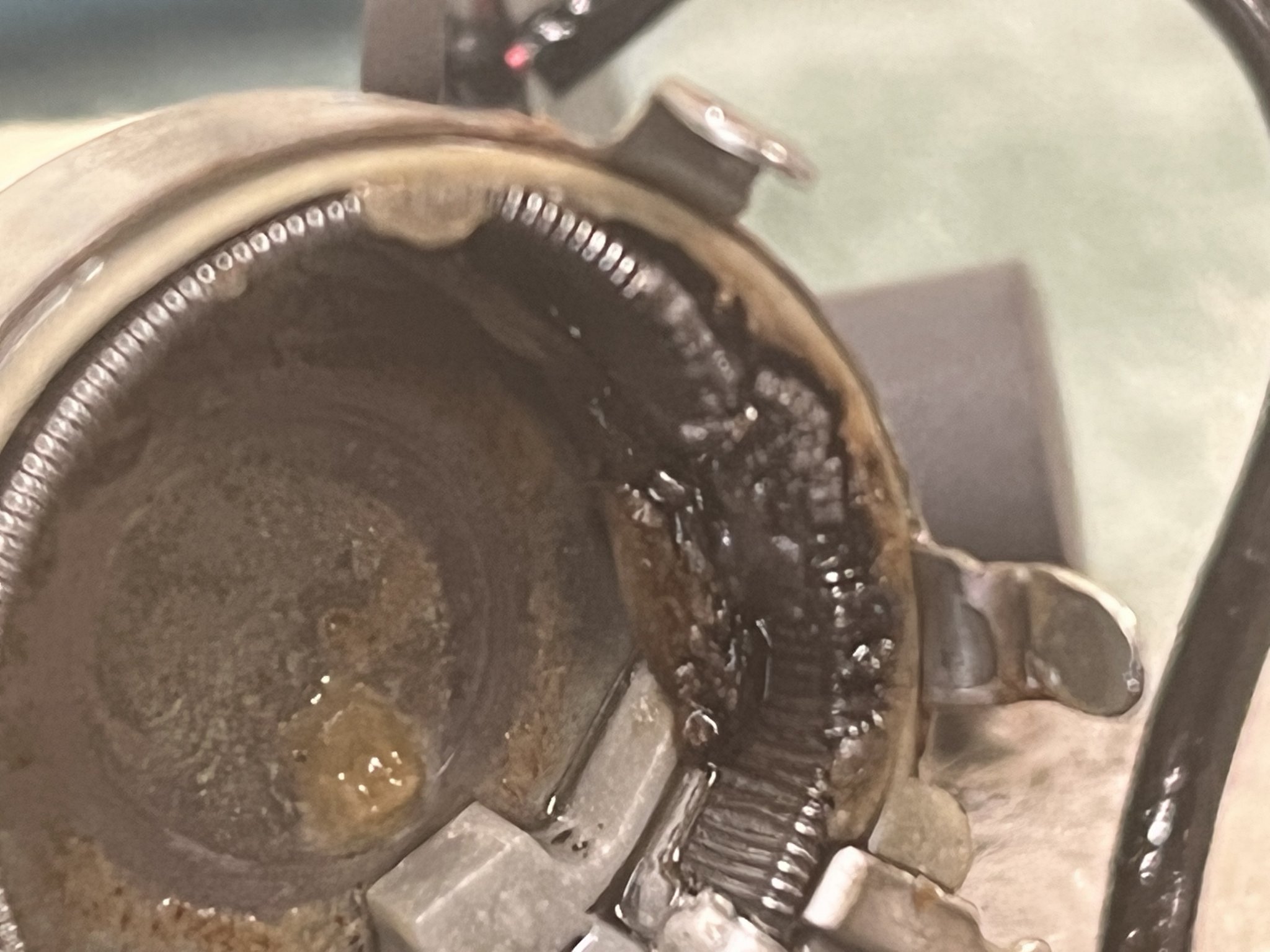

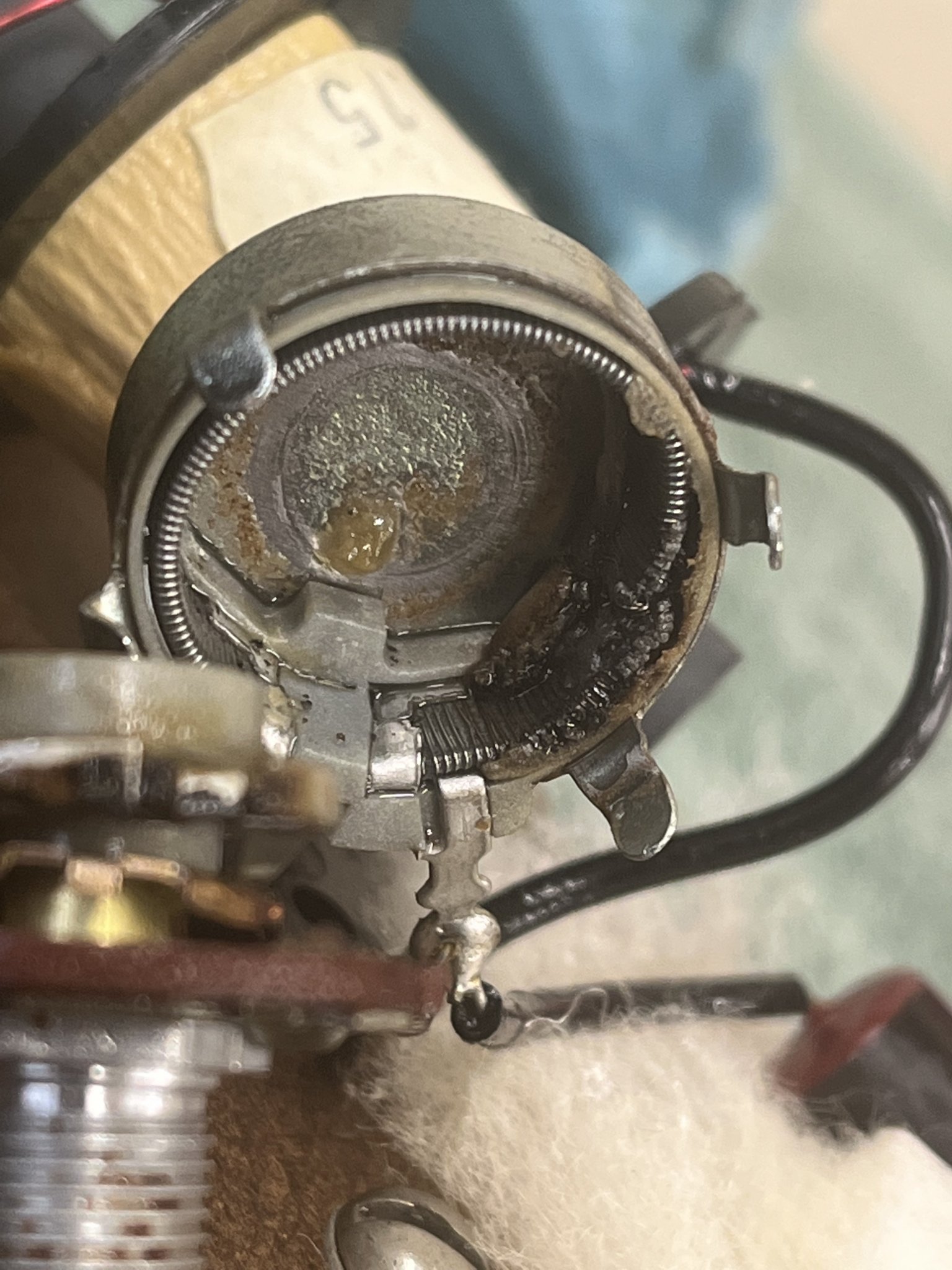

Thanks to everyone for the advice. Turns out that one of the tweeters was bad so I replaced both tweeters with some Dayton audio one that (almost) fit in the holes. I also replaced the capacitors with Dayton audio film caps. One of the l-pad is destroyed. I guess grandpa played these a little too loud. Can’t seem to find a replacement for a 50ohm pad. They do sound much better with new tweeters.

Yes, a 50 ohm, 5 watt, wire wound pot is a suitable replacement.
Note to SleepySantone: These controls are not constant impedance controls (L pads). At the time the W60E was produced, Wharfedale were still using simple pots.

It is the mid control that is messed up. I think I will order the one provided next swap it out.I edited my previous post as I now see that the top pot (treble control) is wired as variable resistor.
That makes sense as it will be handling more power than the treble control.
Go for a higher power rating than 5 W if you can find one.
