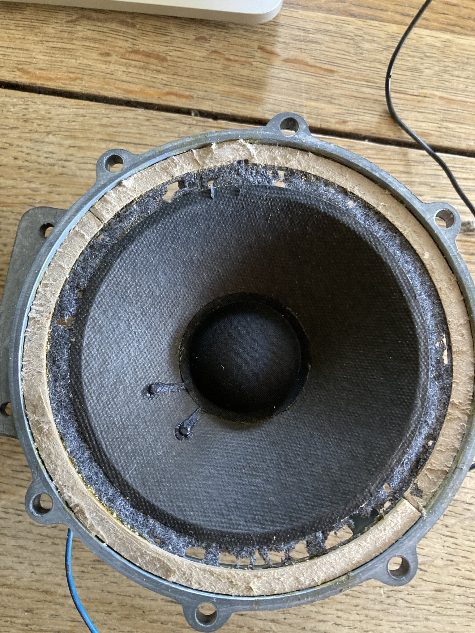

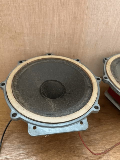

Ive stripped them down, and both the tweeters and woofers are excellent , but both of the mid range (Super 5's?) have some degradation around the cone surrounds, roughly about 1cm holes in both, so how do I go about fixing these, I cant find anything as easily as I did on the HB's, I don't want to just swap them out....thats my question then, how do I repair these??

I'd caution against replacing the cloth surrounds unless absolutely necessary. Simply patching the 1 cm holes may suffice. The last thing you want to do is risk damaging the paper cones.
If you do wish to replace the entire surround, note that the cloth is attached to the rear circumference of the paper cone as shown in the (large) attachment. However, you could equally, and most conveniently, attach the cloth to the front circumference. A sharp scalpel blade can be used to simply cut through the cloth round the circumference of the cone. Then you will then have the happy task of separating the cloth from the speaker basket.
For interested parties, here is the speaker we are dealing with:

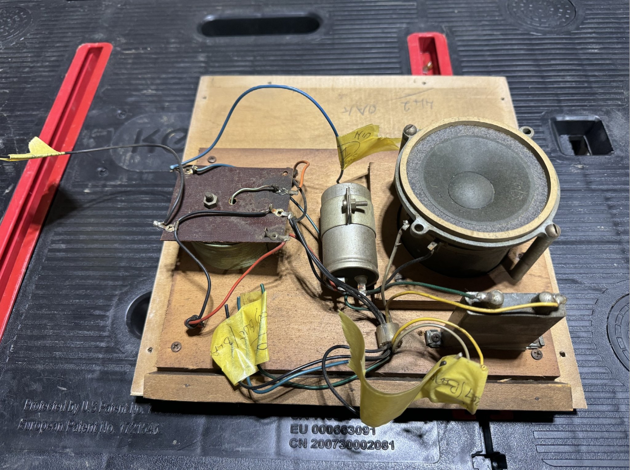

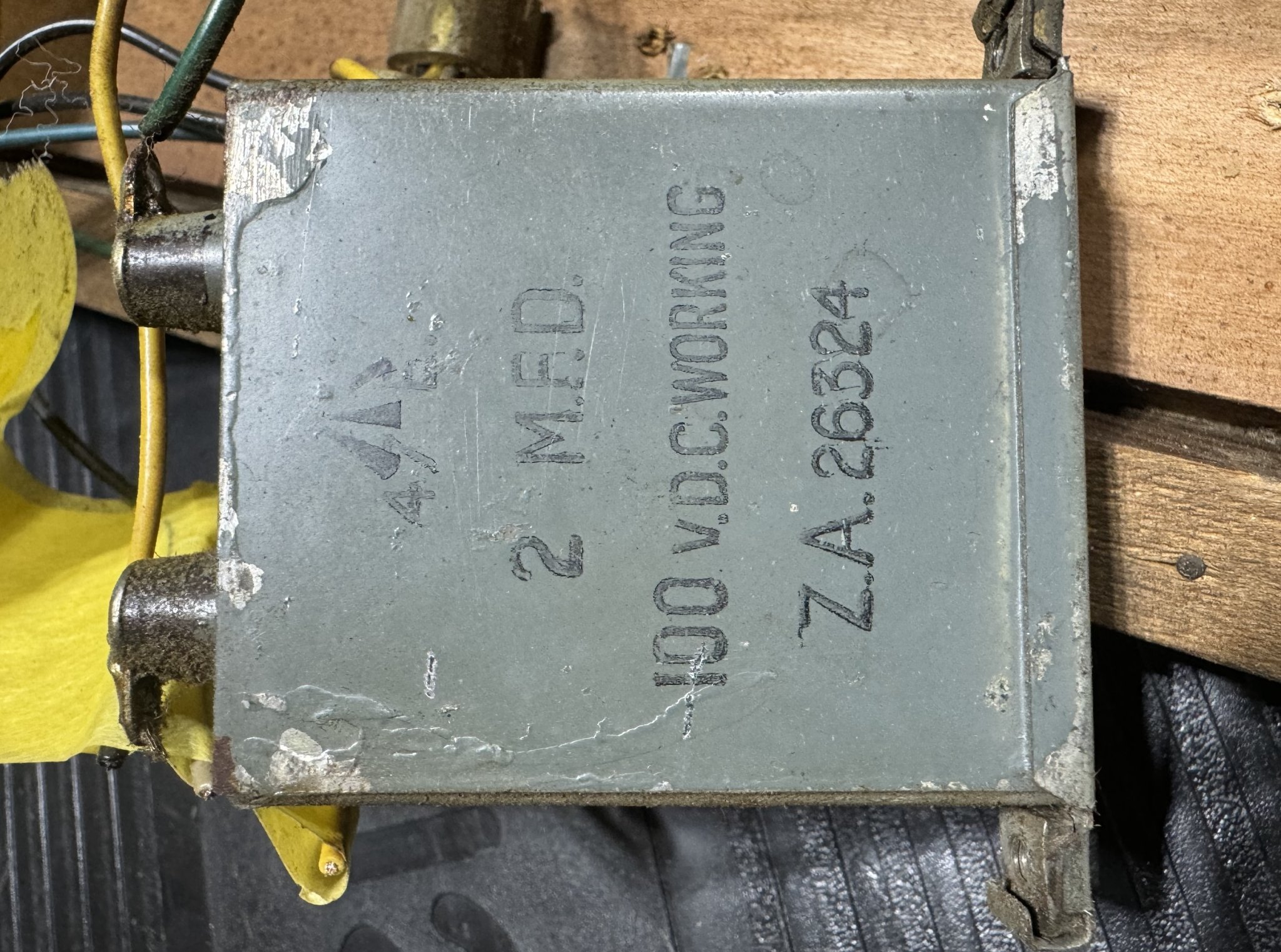

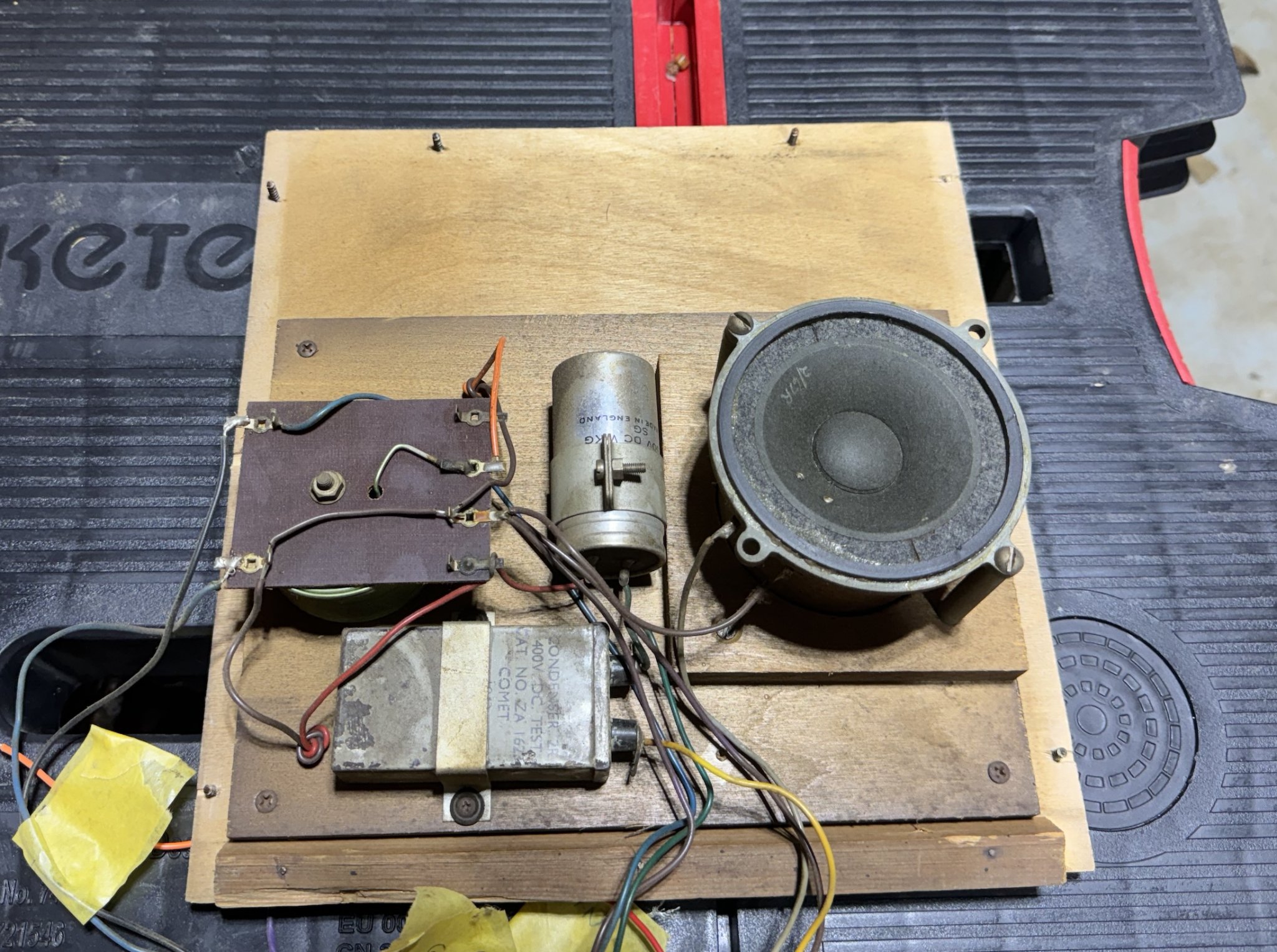

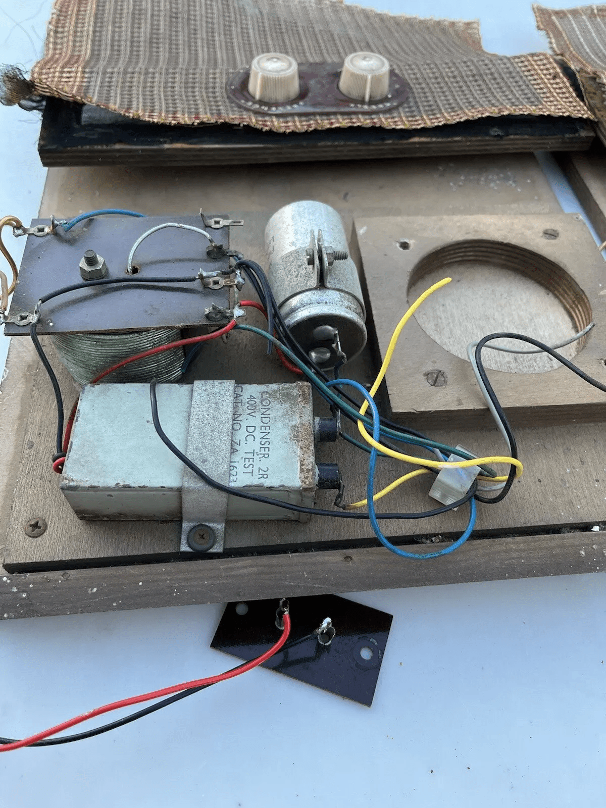

Galu your help is much appreciated, I think given the mainly small or indeed very small nature of the holes, I may well do as you suggest with some patching (see picture, still on the boards as I am working on the cabinets 1st)....perhaps I could get away with some tissue paper / or the Japanese stuff you see being used on the repair shop?...I will get some of that glue though, as the reviews for it are excellent !
One other question (for the moment anyhow), the cross overs are slightly different between the two speakers, now I am going to guess that the one called MK 2 on the pictures attached which has the Grey Chappy image in the mix (as such) has had the grey rectangle bottom left in image Mk 1 replaced at some point (sorry about the names here, Im learning on this stuff), But, if this was the case, I would expect to see holes from the strap fixings where it would have been (as per MK1 location)...but no holes are present on MK 2 image??? Any thoughts

I would patch the holes with thin cloth, perhaps from an old cotton T shirt.
In this W3 image, the cylindrical capacitor is a 12 uF bipolar electrolytic one and the rectangular block is a 2 uF paper in oil one.
A 2 uF rectangular block capacitor is present on both your crossovers. They are simply of different sizes and in different locations, and you'll see that each has a yellow and black wires connected to its terminals.
P.S. The inductor is 2.5 mH and wound with aluminium wire so don't disturb its connections.
It would be advisable to replace the 12 uF bipolar electrolytic capacitor as it has no doubt changed in capacitance value and series resistance over time.

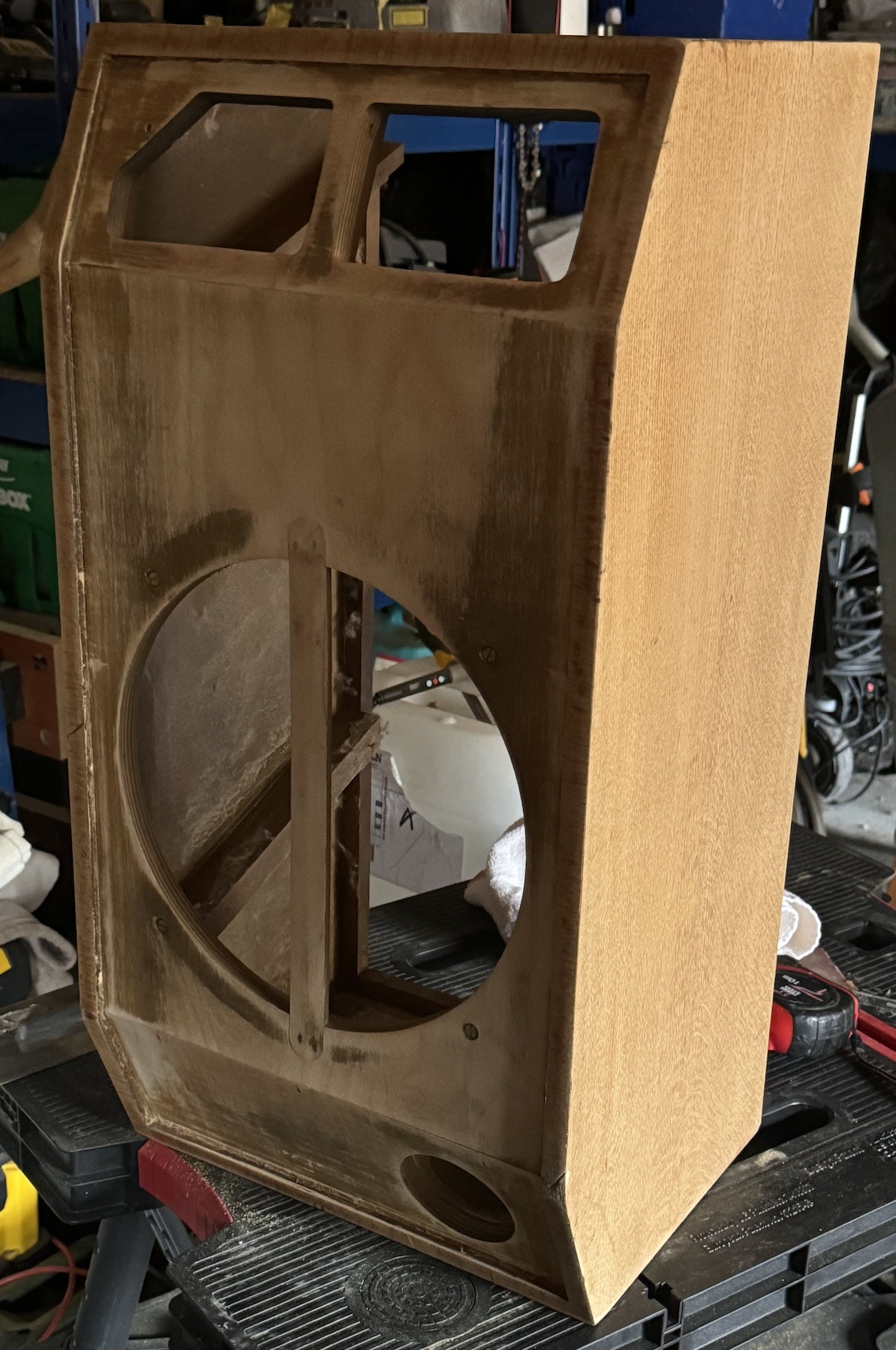

Final question for now then, and Ive asked Wharfedale directly on this, they kindly came back to me saying no idea, there was a fire in the 70's and everything was lost... My intention with these speakers is not 100% originality, the face of the speakers is, to me at least, is pug ugly, so I intend to construct an inset 3 winged cover, held on by small magnets, so one can see the speakers, or not....now the question
The bar across the woofer aperture, its set into the baffle, but its only half the depth (at most) of it, I cant see its structural, the baffle is plenty thick, I guess it was there for protection alone, Im sorely tempted to remove it, spoils the view ( and these WLS/12 have a nice open cone ) any thoughts ?

The correct WLS/12 woofer is fitted with a thick expanded polystyrene diaphragm, known as a 'bung', which stiffens the paper cone and provides a degree of high frequency filtering.
I presume the bar across the aperture is there to give the additional physical protection that an open cone woofer would not require.
So take into account that the expanded polystyrene is easily damaged by the likes of probing fingers!

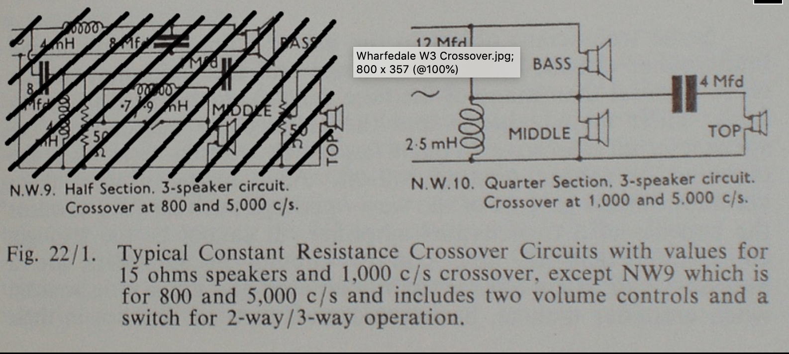

The attached N.W.10. crossover schematic will aid your friend.
The schematic is extracted from Gilbert Briggs' book 'Loudspeakers', but the 4 uF capacitor is the wrong value for crossing at 5,000 Hz.
Please note it should be a 2 uF capacitor (as fitted in your W3), an error that was corrected in Brigg's follow-up book 'More About Loudspeakers'.

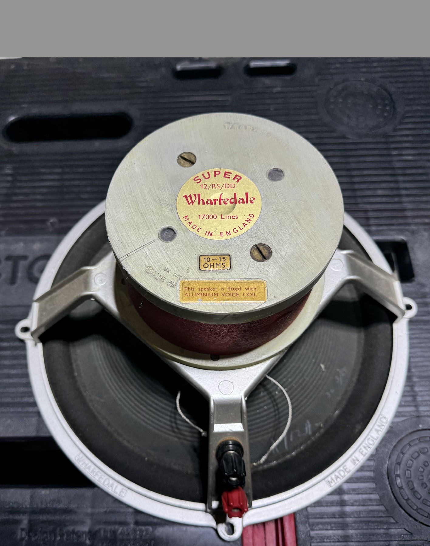

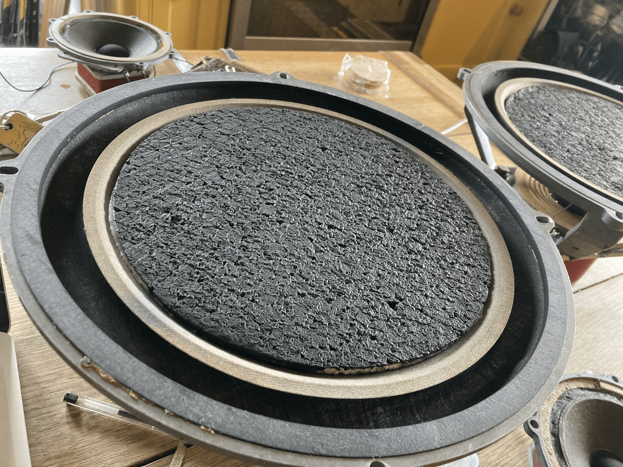

Now....mine don't have the bungs (neither of them) , they say 12/RS/DD so, I don't know but, they sure look period ( and pretty nice) , and no probing fingers here, all grown up, although 2 left at home I cant get to leave, one of whom has an ideal room for listening in !...🙁

The W3 speaker was introduced in 1959.
You have the much respected Super 12/RS/DD (12"/Roll Surround/Double Diaphragm) full range drivers which appeared in the Wharfedale catalogue of 1963, by which time the WLS/12 drivers will have been discontinued or not made available as individual units outside of the W3 enclosures.
This would suggest that the Super 12s are replacements, but pretty much of the period.
The Super 12 has a similar bass resonance frequency to that of the WLS/12 (in the region of 30 Hz) so should match the reflex tuning of the W3 enclosure.
The sound balance is likely to be different from the original configuration but, as you have no means of comparison, you can rest happy if your W3 speakers sound good to your ears.
Details of the Super 12/RS/DD are given in the (large) attachment.
