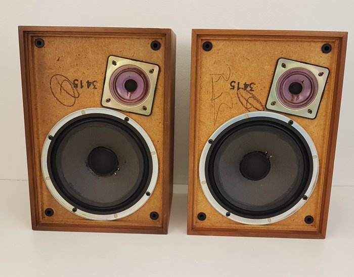

I'm familiar with two types of "purple tweeter" that were used by Wharfedale - the dome type shown in the image of the Triton 3 in post #1 (which was also used in the larger Dovedale 3) - and the cone type used in the smaller Linton 2 and Denton 2 (which, with its open back and plastic rear cup, was actually a mid-tweeter).
Wharfedale Denton 2

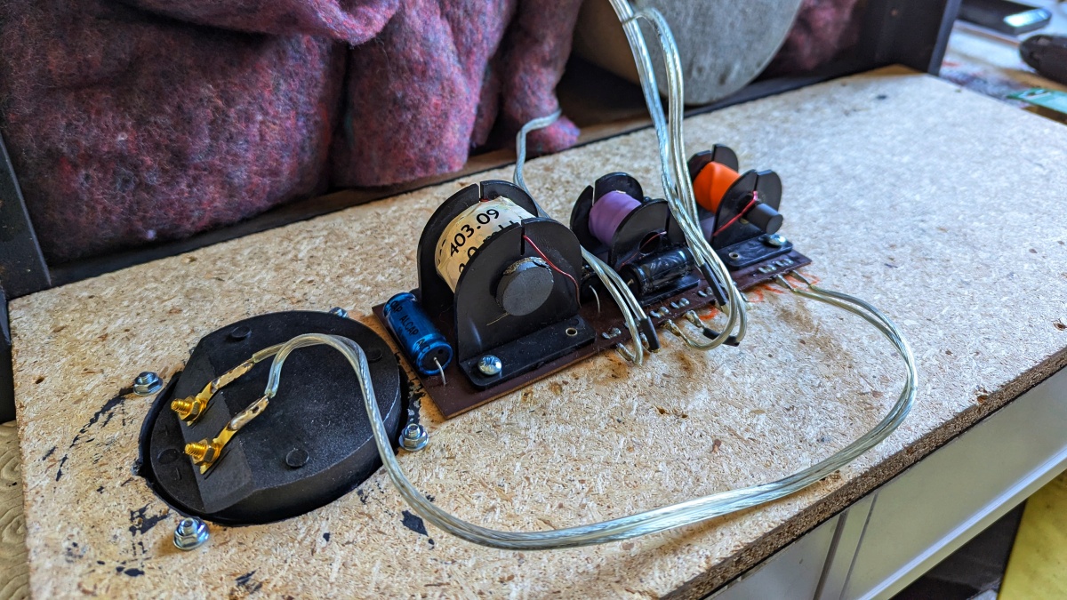

I've been a bit slack about updating with progress, too much to do, and too little time in which to do it. I replaced the capacitors on one of the crossovers a few weeks back, along with all the flying wires to the drivers. A week later, I did the same to the other crossover, but stripped everything out of the cabinet. I nearly posted asking about replacing what ever that cabinet wadding is, but decided to just live with what ever it is.

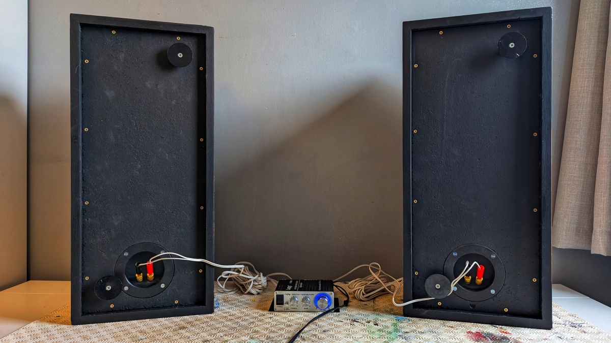

The weekend after that, I broke out the router and recessed new speaker terminal units into the back plate of both cabinets. They were given a sand down, and a lick of blackboard paint, before being left to dry. After that, they were both put back together and confirmed to be working, in so far as each of the drive units was issuing noise.
Haven't had a chance to get them setup anywhere in the house to give them an extended listening session, and might not be able to do that for a while. I'm considering making new grilles for them, as the existing one are a touch tatty, but unsure if that'll change the look of them too much from stock.

The wadding is wool felt made from recycled fibres and is a very effective sound absorbent.

One of the MDF boards has been creased a bit, and is now a bit floppy as a result. I was just wary of going for black cloth on any replacement, in case it looked a bit too crisp and new. I suppose the only person who has to live with it (at least for a while) is me, so I should stop overthinking it...
